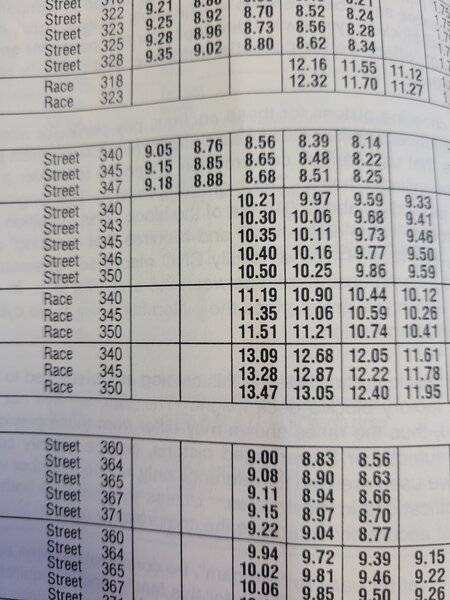

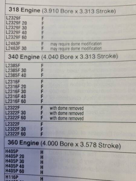

Before I can give a realistic opinion, I have to know: what is the CR now, and what do you want it to be ? You can do all the things everyone mentioned, but why ? Let's not jump to solutions before we know what the problem is.
