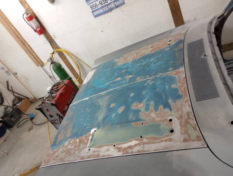

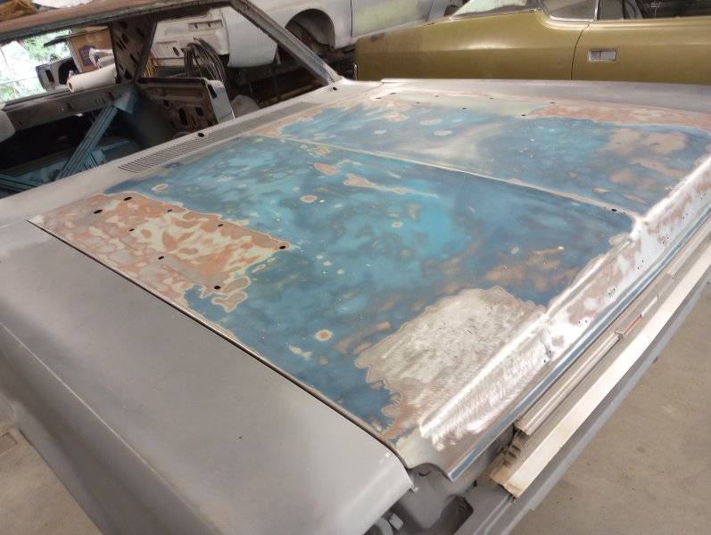

I'm doing a lot of metal replacement and used the Bloxide primer you suggested. My question is what paint products are you putting on top of the weldable primer? From what I understand it is an etch primer?
And nobody wants you to mix products.
Thanks for your time.
I rough up the excess bloxide pretty good with some 120 paper and epoxy prime over it.........on the exterior body panels I pretty much remove it with a DA
