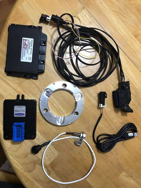

I am currently installing the same package, 2006 6.1 Hemi/NAG1 Trans, into my 1967 Belvedere II. Using the HotWireAuto powertrain management system along with the Holley Blackheart Transmission Cross member. I just discovered the toner ring issue...the diameter is approximately 1" too large. I spoke with Chris last week about this and he told me about someone with the same issue that modified his toner ring. I guess that it was you? I am curious to know how you did the modification?
Also, I am waiting to hear back from Sound German Auto about their wheel speed sensor setup...per your comments in your video.
Your Charger looks and runs Great! Your attention to detail is appreciated!!
Hey thanks! Well Chris has kind of abandoned me on this. On 12/21 he told me to "stick with him and he would send me a care package with different TCM and other modules to try out". I agreed but told him I was frustrated to spend all this money and have a car that was not driveable for this simple thing. He doesn't offer a different tone ring and I mentioned again that Russell Drake has what looks like the solution.
Well as of 1/12/2022, I haven't heard from Chris nor have I ever received anything.
Tomorrow, my new tone ring and controller setup from Russell Drake at Sound German Engineering will arrive and I will be installing it into my car.
I've been holding off doing any videos pending this (and if Chris was going to follow thru on his promises).
Will have something up soon, I'm hoping this will not only fit (as it mounts in front of the output propeller) but also gets rid of the 2 ABS sensors with only 1 sensor.
Stay tuned......

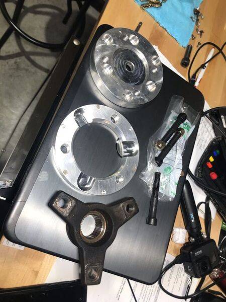

Since you’re done not a problem but there is a 4 finger flange for the output shaft, off a Dodge Sprinter Van, can use driveshaft too just needs to be shortened. Made the same as the one you had made up but no adapter.

Just received my Russell Drake NAG1 solution tonight (1 day early I might add).
Now to get this installed!

Here's a few progress pics from last night -

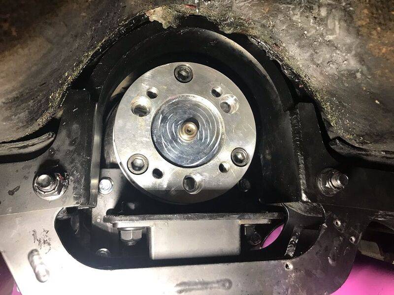

1. Using a 30mm socket, remove the rear output flange and slide it off output shaft.
2. Slide on new tone ring with indentions facing rear of car.
3. Slide factory output flange back on and reinstall 30mm nut and tighten.
4. Next I installed my 3 to 4 bolt 1350 u-joint adapter and bolted it up.

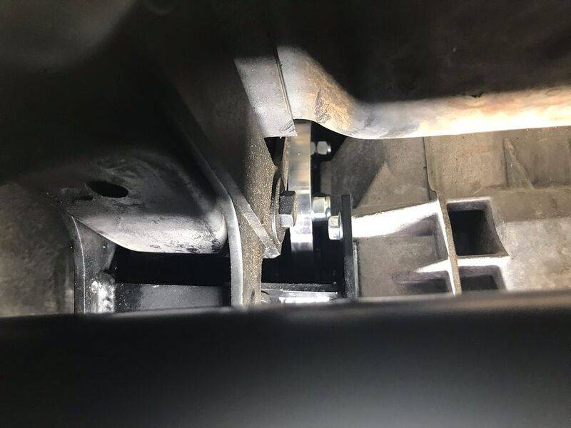

5. Then it was time to remove the upper NAG1 mount to crossmember bolt to install the sensor mount.
6.. Put bolt thru mount first and then install sensor - ensure sensor and jam nut are flush to each other.
7. It's tight so an open-end wrench is necessary to tighten the mount and bolt back up.
8. Ensure all connections are tight and run wire so not to interfere with any moving parts.
Tonight I'll finish up the wiring to the plug and it will be ready to test.
