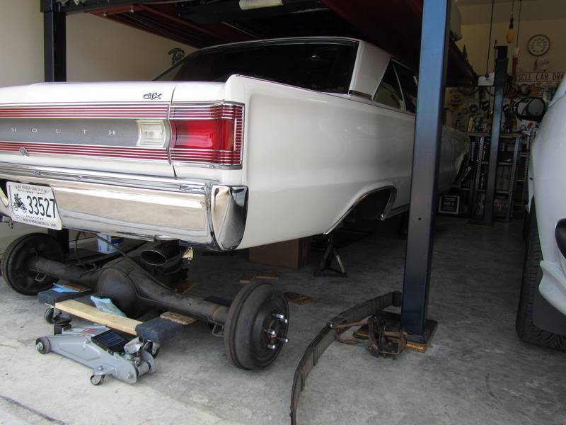

Not sure if this has been said. Jack the car up fairly high, jack stands under rear frame rails, jack stands under the rear axle housing, remove the rear shock nuts & loosen, the shocks, loosen the u bolts & let the drop down, loosen the front spring hanger nuts, slide the spring back. Then loosen the rear shackle. Slide the shackle out of the way. Drop the spring. PM me I can give you some spring package suggestions.

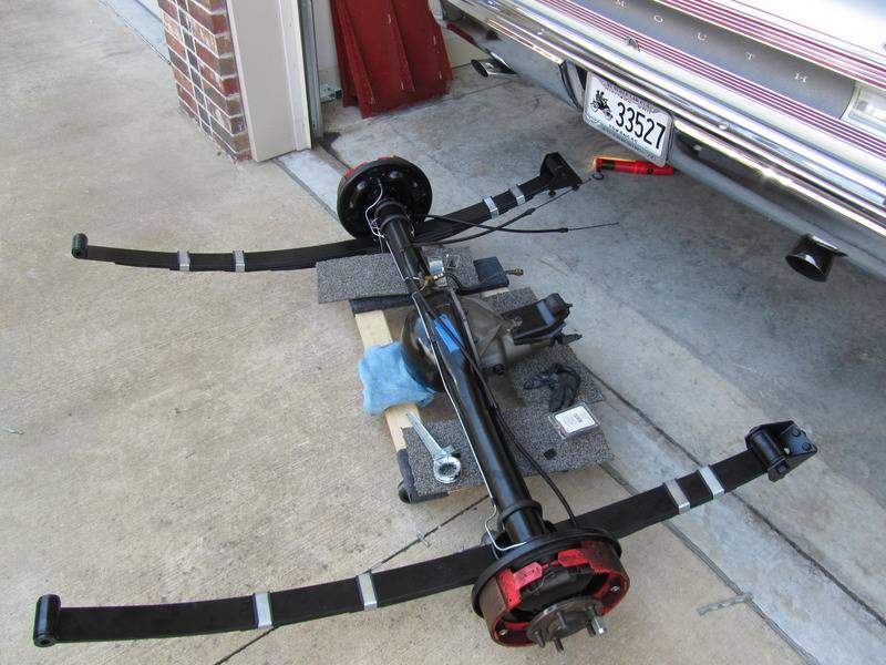

Get the tail way up in the air and start busting bolts loose. Remove the wheels, pull front spring hanger bolts, unbolt shackles, unbolt shocks, disconnect rubber brake line hose, disconnect parking brake cables, either drop entire axle and springs down on a furniture dolly or support the axle assembly and separately remove the U-bolts and pull the springs.

I screwed up on my 1st post(lol). If ur diff stays in place,make sure there's no tension on rubber brake line.
Wanted to thanks again for all the help, had both springs out in 45 min......tomorrow, off to the spring shop for re-curve and add a leaf......we'll see results soon!

Impressive. Took us about 45 minutes just to cut the u bolts off. Please update the results and money spent.

I got lucky, impact gun removed all bolts, no cuttin...
