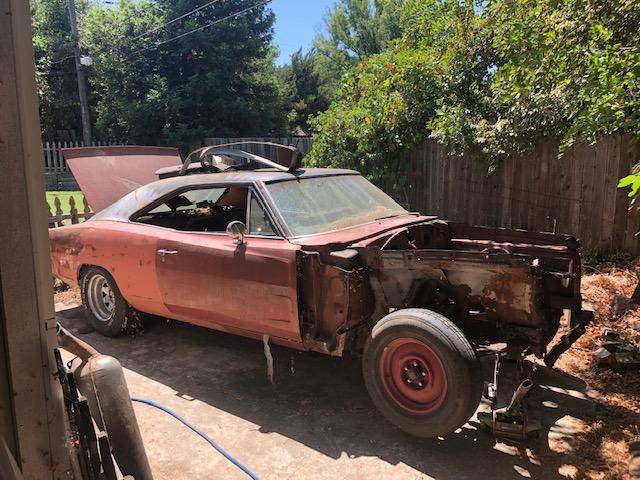

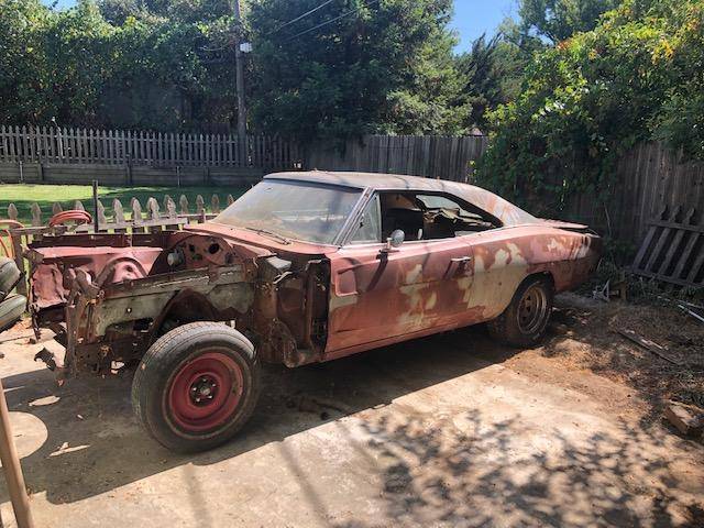

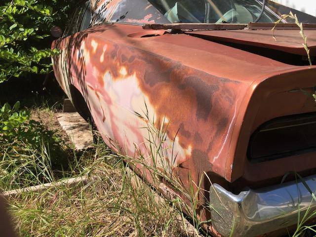

Floors are solid. Rear window channel looks great even though it had a vinyl top. Trunk needs a new floor pan though. No flip top cap or filler neck. Probably a bunch of missing parts that I haven't noticed yet.
It has the original 383 2 barrel. Non original 727. 8 1/4" axle.
Interior obviously has suffered from the ravages of time.

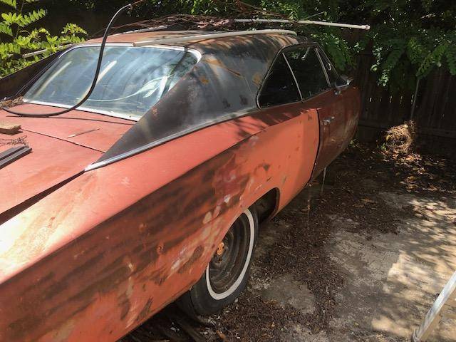

FK5 burnt orange with matching interior. The 1970 Charger models were as follows: R/T was the performance model and had an XS in the VIN. The 500 was a trim package similar to a Sport Satellite, it had an XP in the VIN. The lowest trim level was the XH. THis car is the XH. I guess this was a lower priced model built to be more cost competitive. Bench seat, column shift, no clock or tach, no tail panel trim.

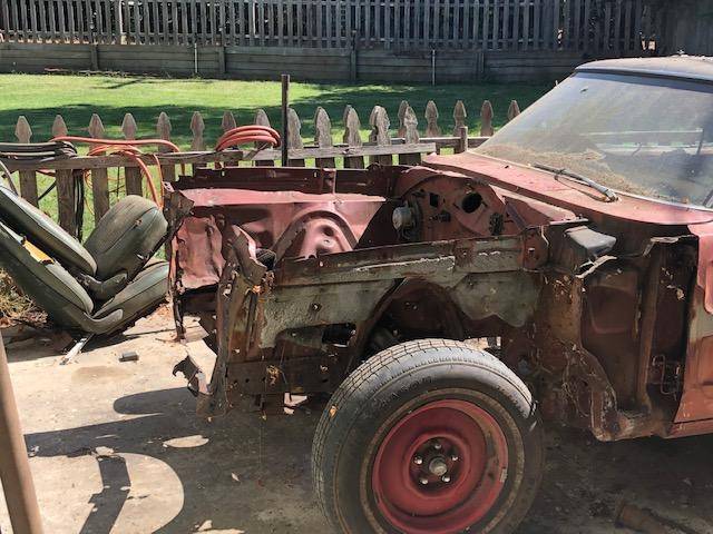

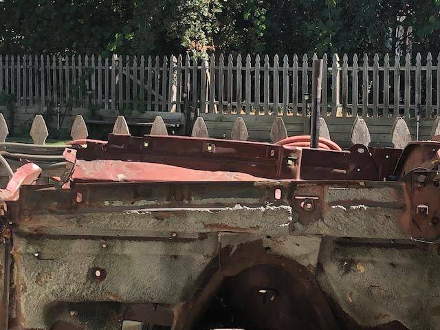

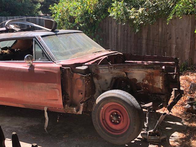

The car was in a parking lot speed collision way long ago. The RF frame rail is bent upward as seen in the pictures.
I had to put a pair of '73 Duster disc knuckles and rotors on it to make it a roller. It might have been a disc car, I don't know. No fender tag and so far no build sheet.

Look across the front. You can see the way the RH fender apron is bent up:

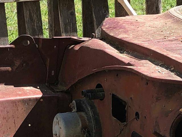

There is also a dent and a fold where the firewall and cowl meet, near the fender-door-hood-cowl area.
I have a core support and frame rails from a '68 Satellite as well as a complete front stub from a '70 Belvedere.
I am thinking of having the car straightened on a frame rack then deciding at that point how to proceed. If the metal all falls back into place , I'd leave it. If wrinkles remain or it looks bad, I could then replace what is needed.

One thing to make clear to the frame shop... The car will be fixed... Back in the 90's a friend took a Roadrunner into a local shop & had them pull the frame "Straight" well when he picked the car up it visually was much better but things didn't seem to line up... I told him we needed to remeasure everything.. He insisted professionals had taken care of it... When the car was finished, painted & beautiful but wouldn't sit level no matter how make sets of springs he changed I convinced him he needed to take measurements.... The drivers rail was still about 3/4" high....
Of course the frame shop denied any responsibility, "It was right when it left here"...
I guarantee they saw an old car that they figured would never be fixed or if it was it would be a beater.... They were wrong... But he had to eat the repair which wound up being extensive...

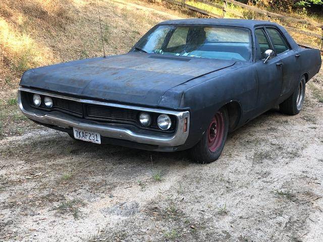

The wagon in Carson city has 11" drums. I'm going to either keep the 10" drums with this axle or some disc brake kit.
It has a salvaged title but it is clean.

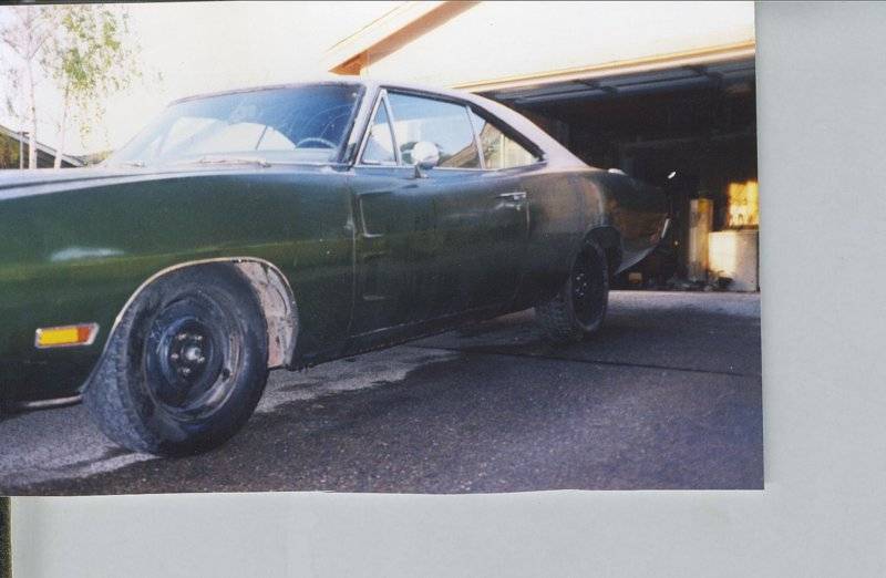

It is surprising that I had to pay $5000 to get a car that needs this much work considering that my other '70 Charger was bought for $1700 in March 2000 and it ran and drove great!
$ 5000:
$1700:
if the door opening isn't affected, and you have the rails and core support; you wont need any frame rack........ it WILL all fall into place; ...... everyone always wants to over think it..... do you have a mig welder?
The doors open and close just fine. There is a bit of an impression at the firewall though.
Mig? Oh yeah...I've welded a LOT over the years. Frame connectors, torque boxes, quarter panels, exhaust systems, I've modified tools, all sorts of mayhem.
The core support on the car is shredded. The RH frame rail is bent upward. I'm wondering if I have the car up on jackstands, could I just put a long pipe on the frame rail and bend it down to match the right side ? Once the frame is within spec, I could weld in the replacement core support, right?
What worries me is welding something and having it somehow "Spring back" from the adjustment. In construction, we often adjust a little past what is needed and once a brace is removed, it springs back to where we want it.
