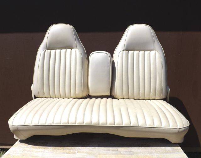

Cool car. I really like the FK5/black vinyl top color combo. Bench seats in a second gen Charger must not be very common? Can't say I have ever seen one set up like that.
You need to put in one of these...
I don't think he said bench seat.
I read buddy seat, which comes with buckets.

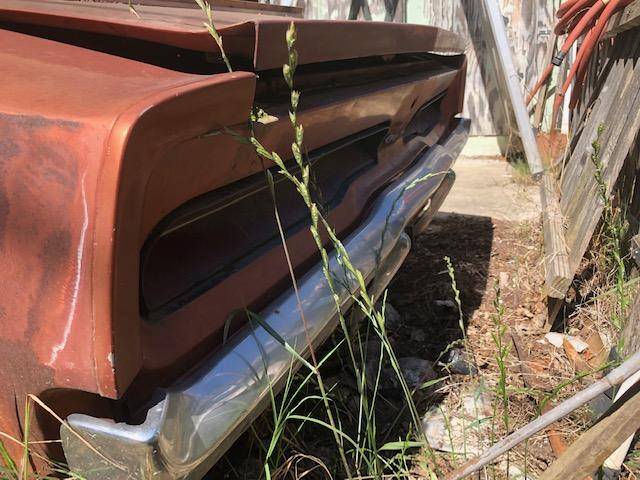

The doors open and close just fine. There is a bit of an impression at the firewall though.
Mig? Oh yeah...I've welded a LOT over the years. Frame connectors, torque boxes, quarter panels, exhaust systems, I've modified tools, all sorts of mayhem.
The core support on the car is shredded. The RH frame rail is bent upward. I'm wondering if I have the car up on jackstands, could I just put a long pipe on the frame rail and bend it down to match the right side ? Once the frame is within spec, I could weld in the replacement core support, right?
What worries me is welding something and having it somehow "Spring back" from the adjustment. In construction, we often adjust a little past what is needed and once a brace is removed, it springs back to where we want it.
I'm assuming you have no anchors in your floor; you would have to chain the front of the rail to the floor...... also, you must be chained to the floor somewhere behind the rail. I would prob fab up something to attach to the spring hanger ............. then jack on the T bar member where it meets the rail, or on the rail itself somewhere behind the bend........ "spring back" is another myth; yes, you "over pull" a bit, but once your done it won't go back
ME? I would just replace the rail and inner , maybe both rails, inners, and core support as a unit, just cut everything that's bent off......... the hood and fenders, will dictate everything

OK, I'll say I have never seen a pre-1971 Charger with a bench seat.

The seller is almost as excited to see something happen with the car as I am. He keeps touting the rarity of the 383, the bench seat, the FK5 color....
Yeah, a bench seat Charger is rare but I doubt anyone gets all wiggly about it. The 383 is not a bad engine but this isn't an R/T model. FK5 burnt Orange looks nice and is a one year only color so that is nice.

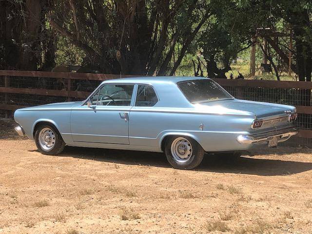

I don't know if this is one that I would keep long term. I see it as a builder that I may straighten out and get running, then sell. I may do the bodywork and paint, I'm not sure. I often go 'round and 'round with these cars with whether I paint them a color that I like or return it to the original color. I've only repainted a small percentage of these builders in their original color. The '65 Dart is DD1 and the Duster is B-5 Blue, they both were built these colors originally.
I get wiggly over bench seats.
I would prefer them in this car (and Road Runners).
A bodies had a type front of seat that is the prefect combination for me.
Fold down arm rest.
