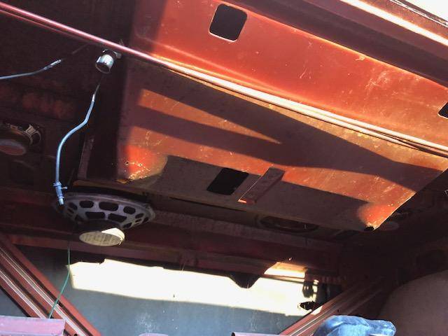

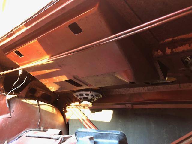

When I replace the package tray, I'll assess what to do then. The cardboard is wasted so when I get the new one, I'll probably just install 6 X 9 speakers.
Looking underneath at the steel under the package tray on both of my cars, there are multiple openings that the factory put in. The package tray structure in this car has not been modified. Those small speakers are sitting in original holes in the steel.
I did wonder that. It was a bit hard to tell from the pictures. Car is coming on nicely by the way. Enjoying watching you get it back on the road.
You can see part of the small speaker on the right side about the middle of the picture.
Above you can see the left speaker. One 6 x 9 is missing.

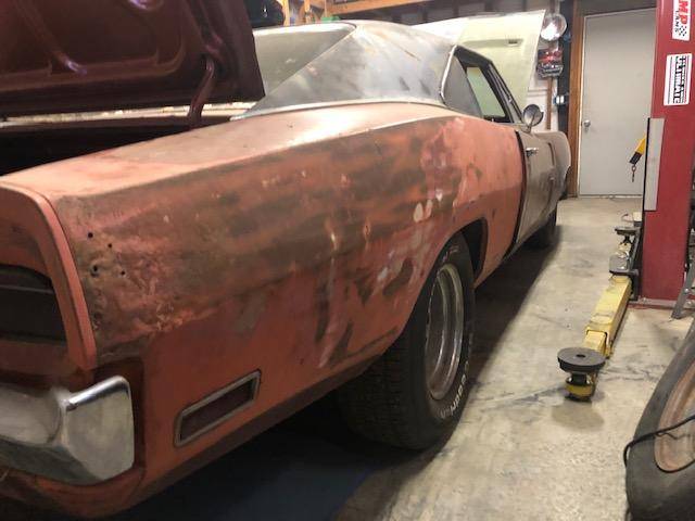

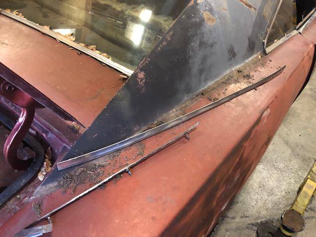

I took another look at the Charger and figured that I could find a few things to do.
View attachment 915337 View attachment 915338

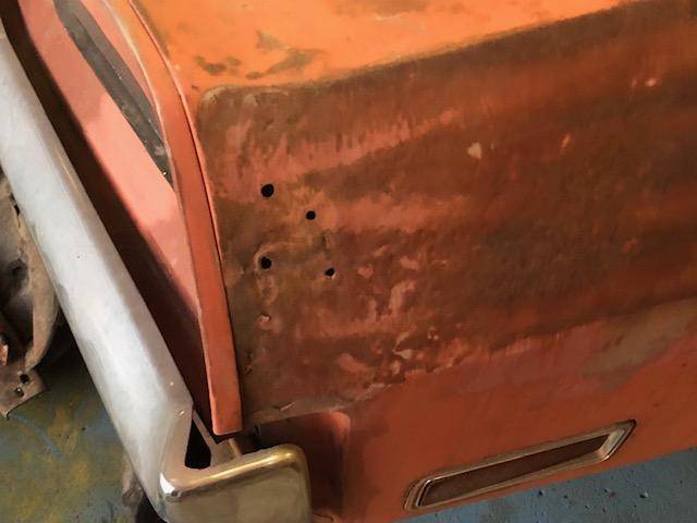

I could weld up the dent puller holes someone else made.
I removed the vinyl top "Check" moldings.
I figured that I could weld up the trim holes since I will not be putting a vinyl top back on the car.

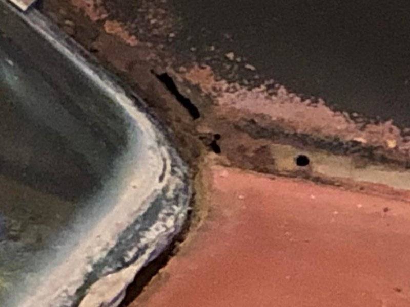

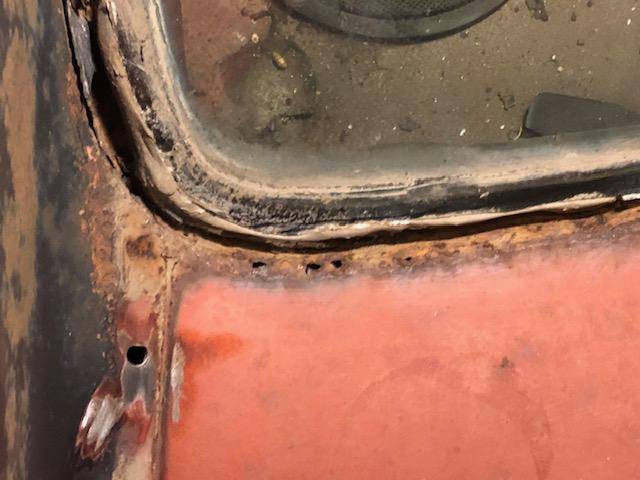

I knew that there was some rust along the bottom corners of the rear window channel.
View attachment 915340 View attachment 915341
Comparing this car to my red one, this one has less rust around the window but the trunk floor is far worse. Strange....
I may find more rust once I remove the rest of the window moldings. The Wife is going to help me remove the rear window and I'll run a wire wheel around the entire channel to see where I need to patch and weld.

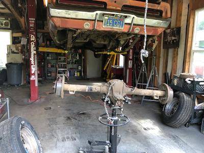

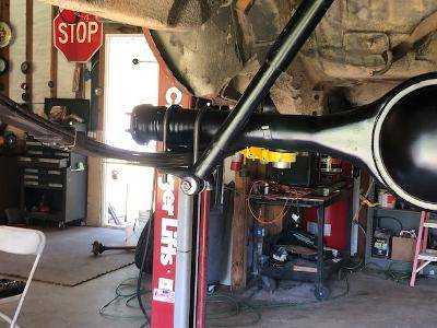

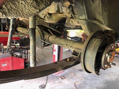

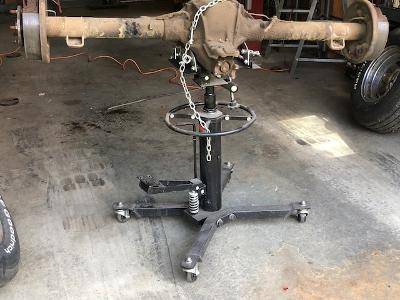

I got the 8 1/4" axle out today.
The transmission jack is a nice tool to have.

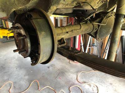

First though, I removed the parking brake cables and unbolted the axle

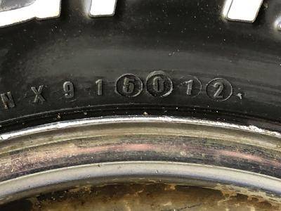

The rear tires I have on the car are only there because they hold air and fit. I looked at the date code on the sidewall:
Does this mean the 50th week of 2012 ?

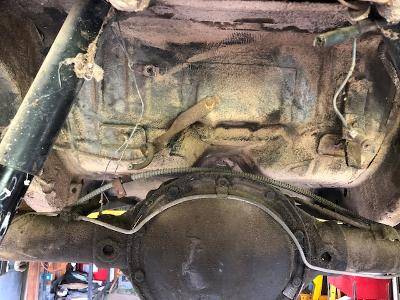

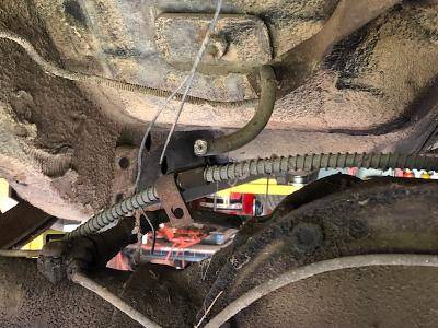

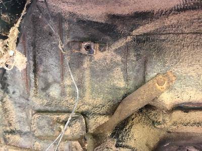

The exhaust pipe hangers:
This car was a single exhaust 383 2 barrel model. Only the right side had a tailpipe yet the floor pan had provisions for tail pipes on both sides. I'll have to look at my red car to see if it is the same.
I don't see an exhaust hanger... I do see the parking brake cable attachment point..
Yep, I think you're right. The shadow of the missed undercoating can be seen in the picture.

This car was a single exhaust 383 2 barrel model. Only the right side had a tailpipe yet the floor pan had provisions for tail pipes on both sides. I'll have to look at my red car to see if it is the same.[/QUOTE]
My car was the same. Its a 73 400 2bbl with original single exhaust. The floor pan had a punched pattern on the left side so it could be drilled out by the factory if the car was coded a dual exhaust. I dare say, the 70 was the same.
I'll need new brake hose. Hopefully it isn't some part that takes months to get!
I think all the floor pans on 68-70 B-bodies had the 4 dimples for a dual exhaust hanger if the car came from the factory with single exhaust.

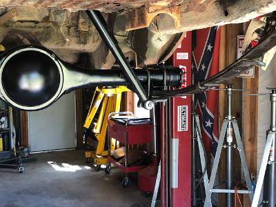

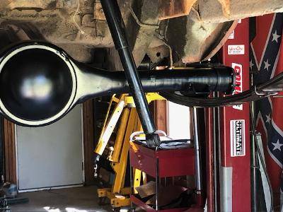

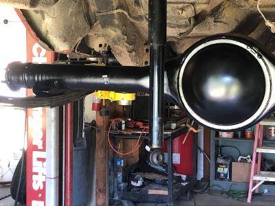

The axle is in.

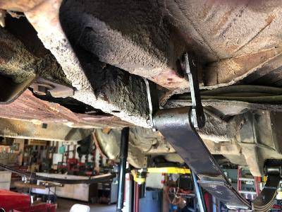

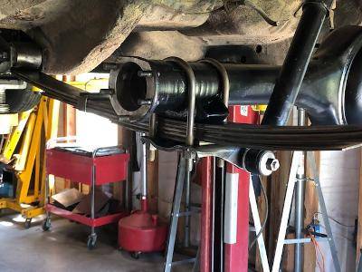

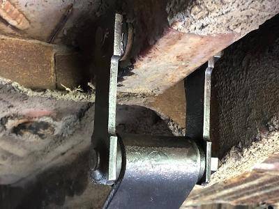

I had some urethane shackle bushings in the shed. I used the poly bushing lube to avoid the squeaks.
I love how this stuff looks when everything is clean.
I bent an axle seal while installing it. Left side is in though. Not able to finish yet.

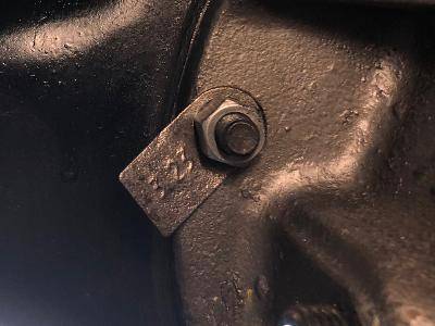

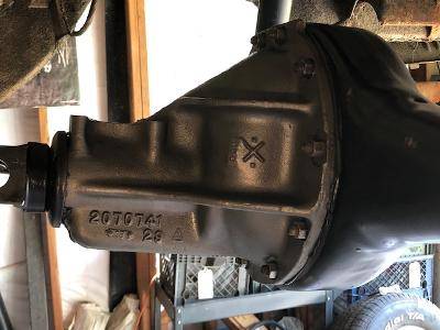

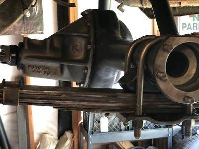

The 3rd member is a '741 unit but I'm okay with that. All the 8 3/4" 3rd members are plenty durable.
It is a clutch type Sure Grip 3.23 gear.
The car will likely get the original 383 back in along with an automatic. I'll have to tear down the 383 to see if it needs a full rebuild or if I can get by with a dingle ball hone and new rings. It is so tempting to go full bore and order a 4.25 stroker kit but I am trying to keep this car a lower cost, reliable and fun project. It is not intended to be a supercar by any means, just a fun cruiser that handles and stops well and can peel out when I want.
