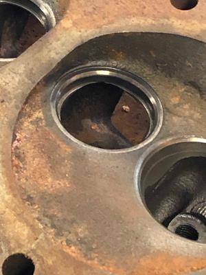

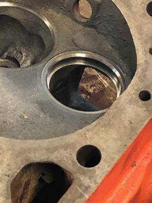

I pulled the valves out and took a look at the ports.
That ring below the seat..... My understanding is that anything sharp that is in the path of flow is a restriction.

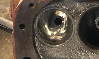

Notice the irregular shape of the ring on this port above.

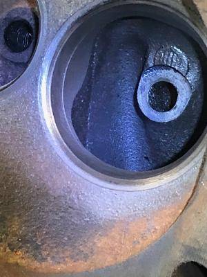

Intake port below. I see a bump to the left of the valve guide. I'm curious if the guide boss needs any smoothing since the flow comes in from behind it and not toward it.

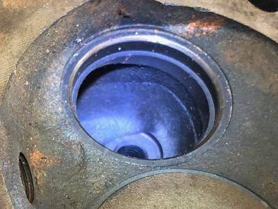

I apologize for the blue shaded light but I needed some light for this picture:
I am running on common sense here since I have no experience with this. It seems to me that when porting, you need to look at which direction the flow is going. For exhaust, I think that smoothing out around the valve guide boss makes sense along with eliminating that ring below the valve seat.

It looks like someone put hardened seats in and didn't do a bottom cut to blend the new seat to the bowl....
You can see in the intake what typical blending is needed.. Those exhaust ports are worse than normal
Smoothing, blending & narrowing of the guide is good, also throw a head gasket on the head, locate it with pins in the guide pin location & look to see how much the chamber overhangs the gasket along side the valves... That is shrouding & unshrouding the valves is beneficial...
Looking at the valves, I can't see more than one angle on the back side. A single angle valve job?

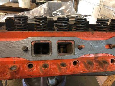

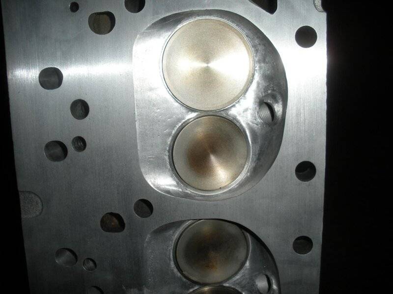

The heads from my red car, "Ginger":

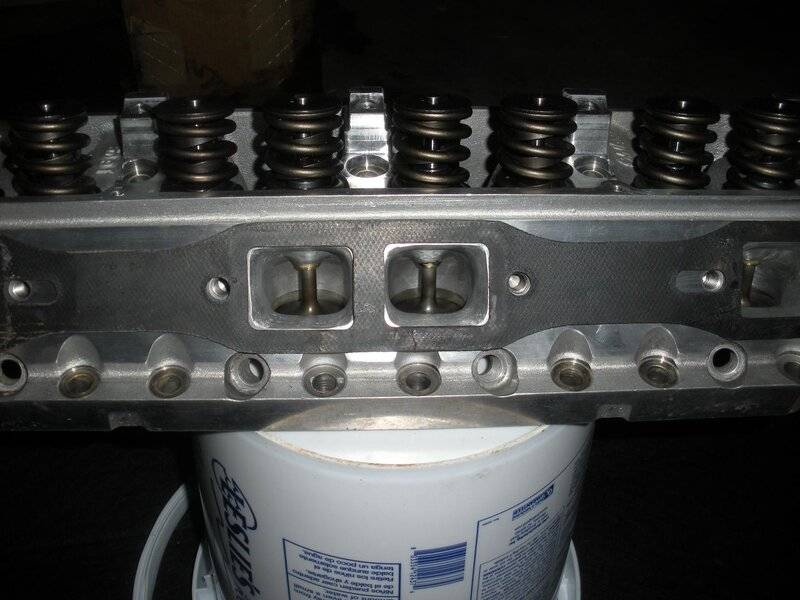

Those same gaskets on a '346 head:
I guess it is fair to assume that there is no way that I could hog out these ports to the gasket size ??

You could... But I wouldn't... Take the easy gains & leave the higher risk stuff alone.. Putting hours into a head only to have it leak water into the engine sucks....
Max ported 906's typically flow about what Edelbrocks flow OOTB so if you want that type of flow save yourself hours with a grinder....
But if your sticking to a budget a few evenings with a grinder is certainly worthwhile..

Is the area below the exhaust seat as ugly in person as it looks in the photos?
No, aside from that sharp shelf below the seats, there is just the usual valve guide boss ridges and some small bumps. It looks like some blending is going to be beneficial.
