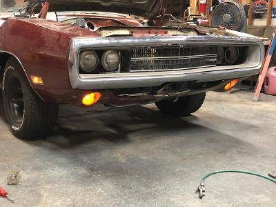

Chipping away at the wiring and lights.
The right headlights lit up along with the center bulbs in the taillights.
I connected a few terminals and....
View attachment 1017381 View attachment 1017382
There was no lamp in the right side of the valance until.....
View attachment 1017383 View attachment 1017384
I went out to the shed and found 2 headlights and the mounting rings and screws.
SCORE ! The left front side marker isn't lighting up. I changed the bulb. I'll check to see if the terminals have power.
I soldered in 2 good used taillight bulb sockets and was able to get the middle and outer bulbs to work.
The inner bulbs are single filament 1156s, right? The right side was really bright and caused the middle and outer rh bulbs to dim down. I just pulled the 1156 bulb and let the inner edge stay dark.
The rear side markers have corroded sockets. I have them soaking in Evaporust.
The headlight door motor doesn't open but I may not have tried the headlights with the key ON. The lights come on with or without the key on but the door motor is on the accessory circuit.

I think all is well now. I have tested the lights and ignition system.

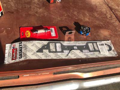

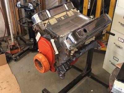

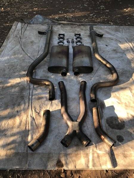

Today I met FBBO member BDF6. He was in town to meet up with family and he brought up a used exhaust system for me. He made me a great deal, $200 for a "Header Back" setup in 2 1/2" stainless, manufactured by Pypes. This allows me to have the exhaust system in place when I start the fresh engine at a price about 1/4 what a shop might charge!
It is a little discolored but I expect it to clean up with some scrubbing.
I am glad to have been able to help the project along.I have what looks to be the exact same Pypes system with the X pipe. I have been very happy with it.
One minor suggestion: The X pipe on mine wasn't cut out perfectly - look inside the pipe and see if it is fully open in there. Mine had some pipe remnants that would have hindered flow a bit. I ground these away with a high speed grinder.
