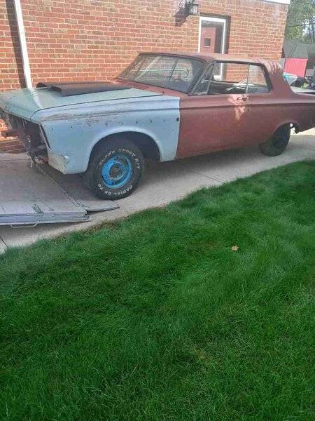

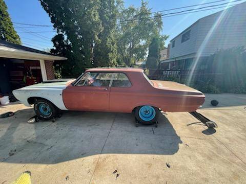

Back on $5000 topic. I picked up this 63 Belvedere stick shift car from a buddy for a lot less than 5G's. Going to be a 413 Max Wedge tribute when done.
20211002_103536_HDR.jpg IMG_0405.jpg IMG_0429.jpg IMG_0427.jpg IMG_0419.jpg IMG_0418.jpg
Good luck with the build, I'd guess that parts for those are not so easy to find.

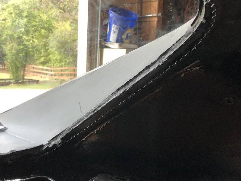

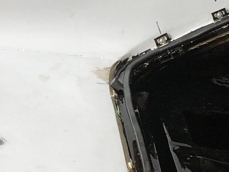

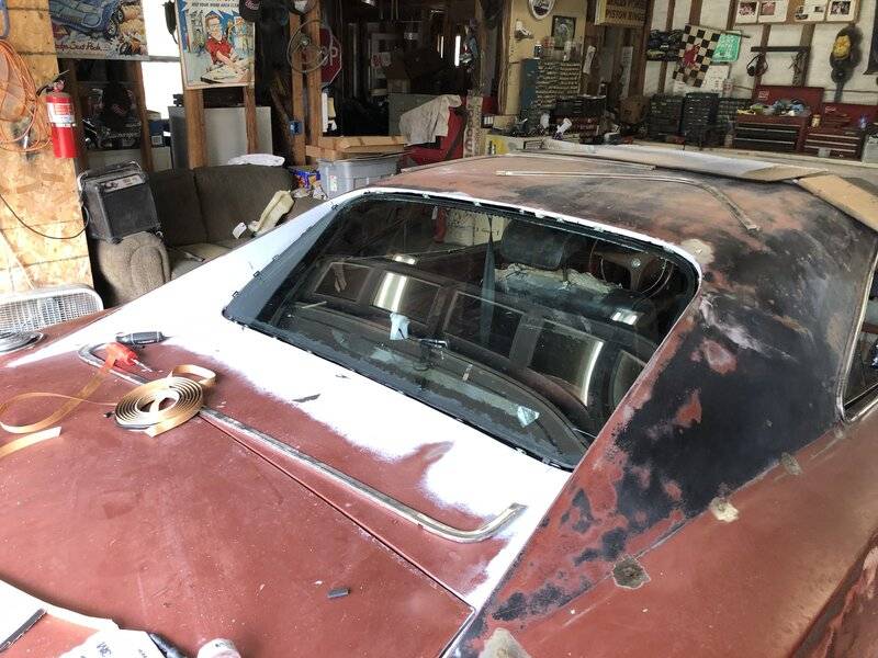

With the rear window channel bodywork done, primed and squirted with a few coats of Shopline single stage black, I was ready to install the rear window.

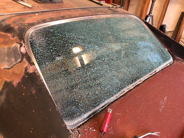

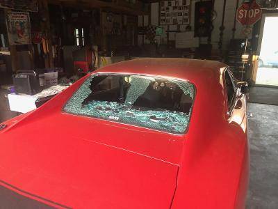

It was just a scant 19 months ago that I removed the original....
In about a thousand pieces!
Yeah....I was prying on the trim to remove a section and I heard the POP.
Crap.
Anyway.....

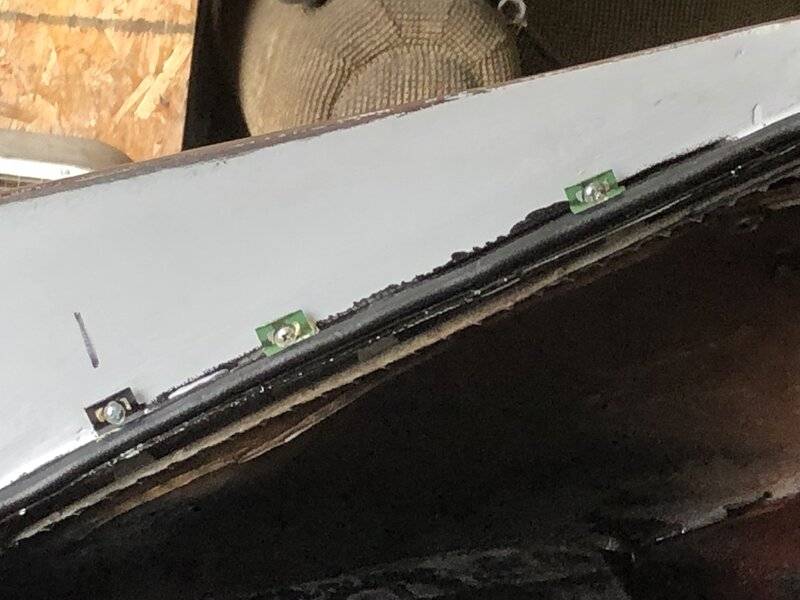

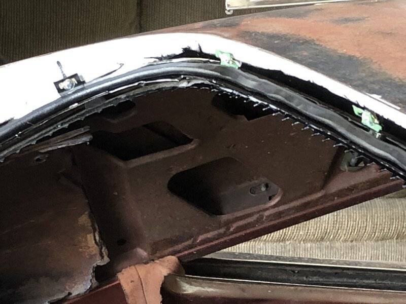

I cut and patched the rusty areas, primed, body filler, high build primer, sanding and then paint.

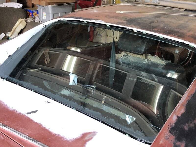

Yesterday I put the trim clips in. Today the glass in in place.
I used 5/16" butyl tape/ribbon and set the glass in place. They provided spacer blocks to keep the glass from sliding down.
I used just over half of the roll. I still have 3/8" tape left over from when I replaced the rear window in Ginger in April...
Doing it by myself, I had a bit of trouble getting the glass perfectly centered. I had to pry it over using a paint stick.
Looking through the glass from the outside, you can tell where the glass squishes the butyl tape and where it doesn't even touch it. The latter indicates a low spot in the window channel. I expected this. To remedy, I smeared window sealant all along the inside perimeter.
Once it set up, I used some MEK and a rag to clean up the edges. Did you know that MEK eats nitrile gloves?
I found that out today....Two sets shredded within minutes. Later I checked using a "Duck-duck-go" search and yeah....there are NO gloves that are 100% safe from MEK. Butyl rubber gloves are the most resistant!
The Wife helped me do a leak test after I got the trim in place. SUCCESS !

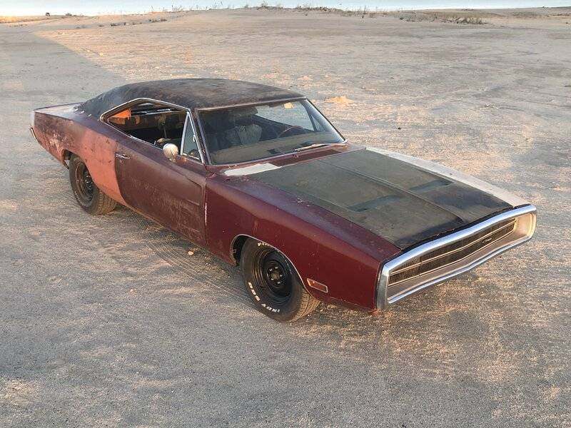

"Jigsaw" runs and drives. I've had it out on the road a few times but until I get it insured, I can't go far with it.
I want to keep it ratty for awhile though. I have a shiny one.
To transfer title and register it, I have to jump through a few hoops. I need some time off to do all of that and the company I joined last year seems to have work going all the time. I might have to quit to move ahead with the car!
