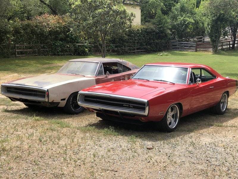

Yeah, I like these wheels that much. Here is my line of thinking.....
I love the vintage NASCAR Chargers....
I'd like to make a street version of that, sort of what I have with the red car but a lot more raw. Black steel wheels, no fancy trim, just a racer vibe.

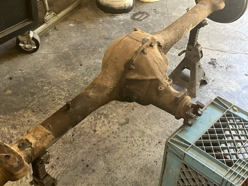

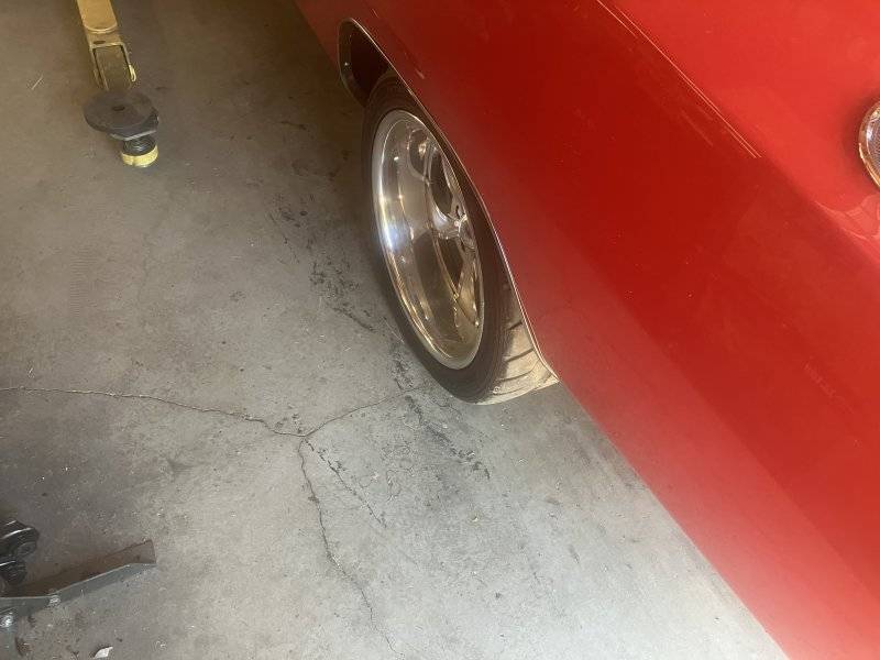

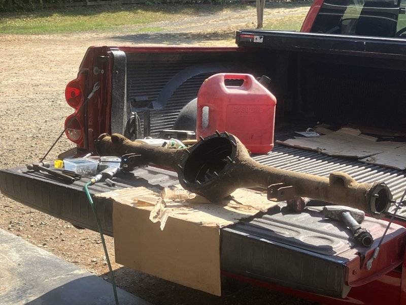

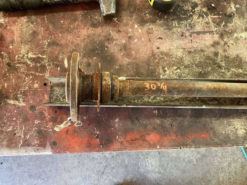

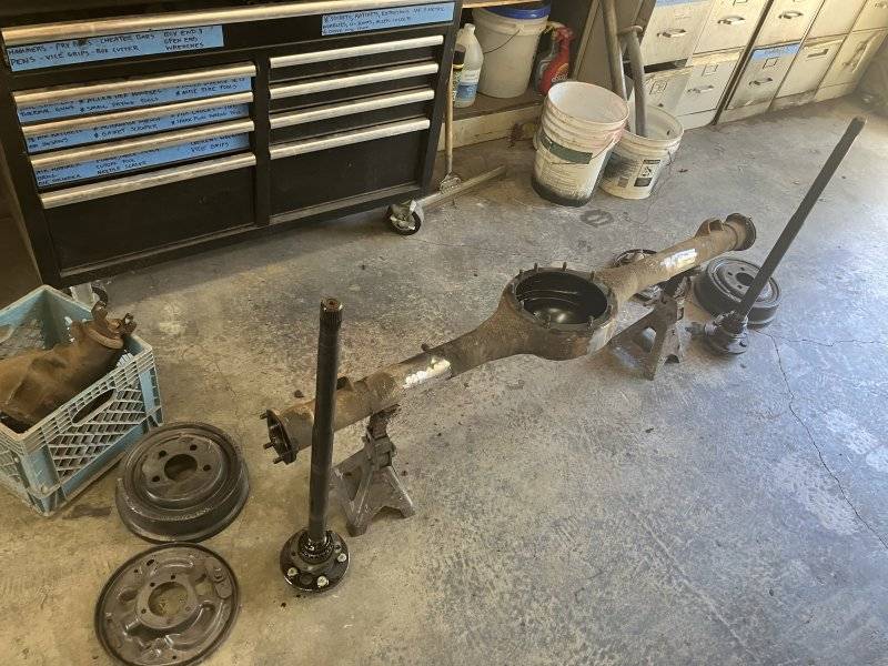

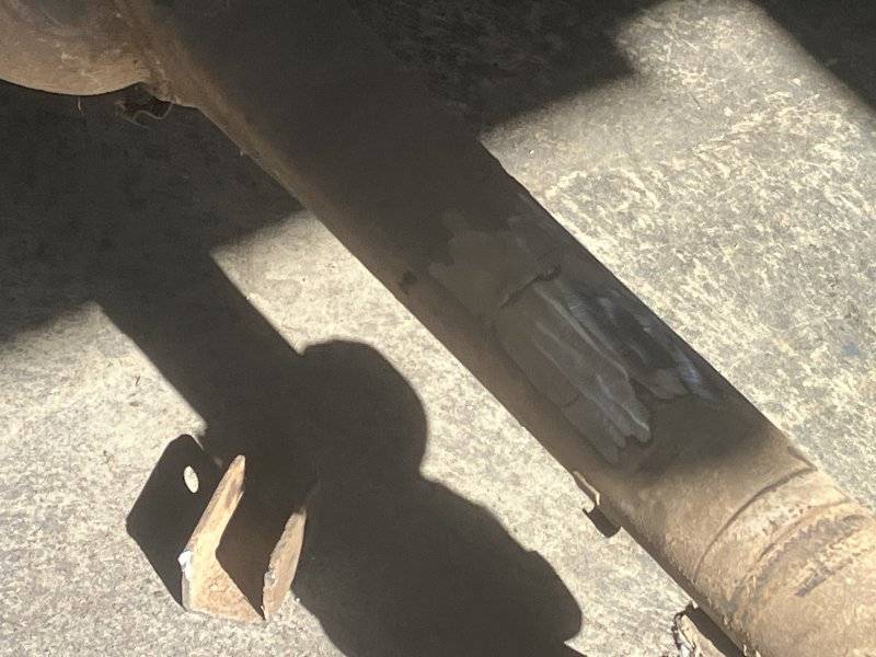

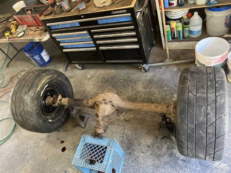

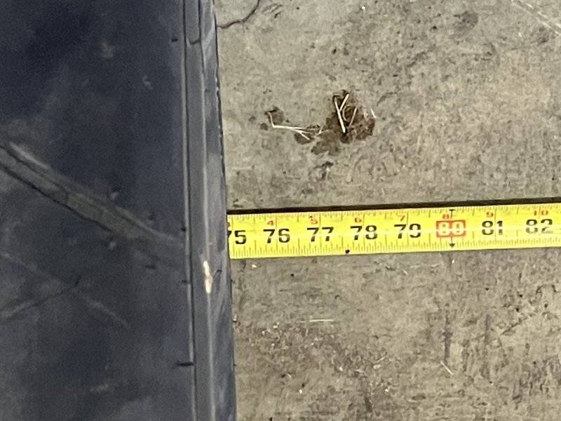

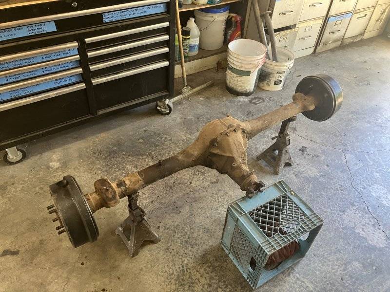

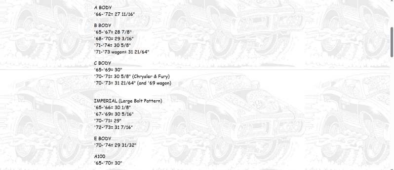

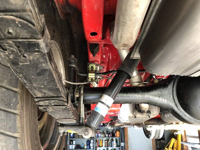

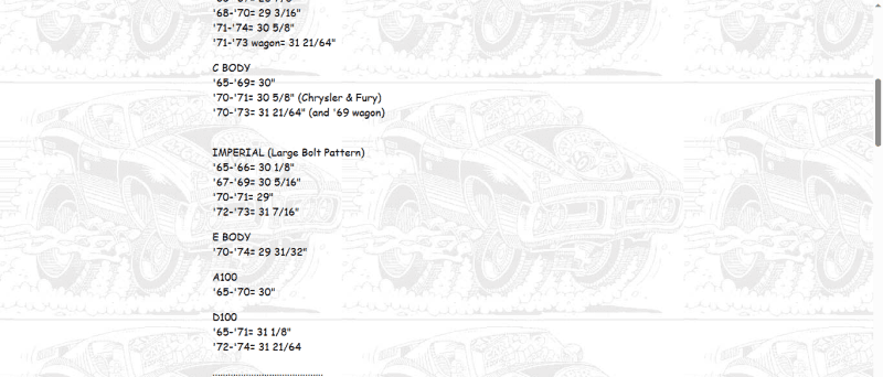

If I had a rear axle approximately 3" wider than the stock 68-70 B body housing, these wheels would fit and look really close to the blue version above.

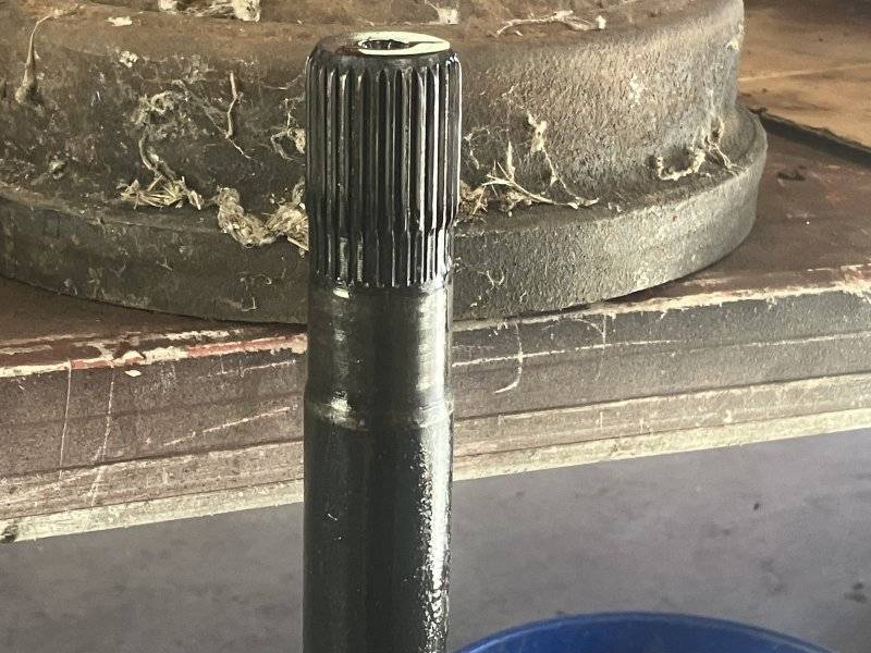

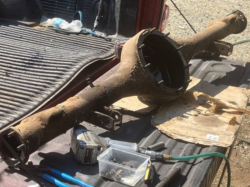

I may start looking for another 8 3/4" axle housing and shafts to get there. A 71-72 B is 3 inches wider, a 70-71 C body is too.

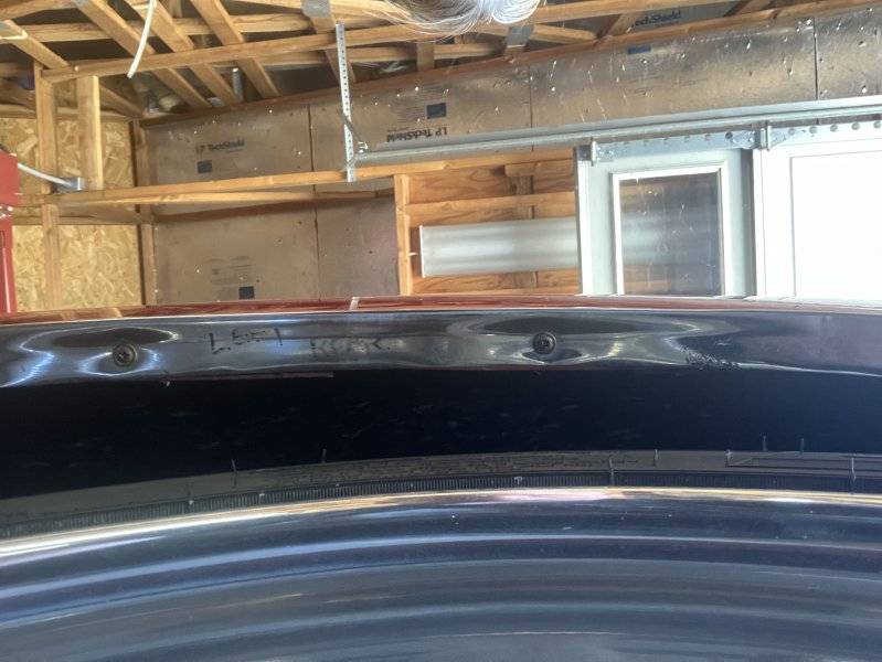

This would allow me to use these wheels without spacers but with adequate clearance to the springs and inner wheel houses. I don't want to move the springs, I don't want to tub it, I want the body and frame structure to remain stock. Swapping in another 8 3/4" axle would allow me to retain the 3rd member, drive shaft and brakes.
