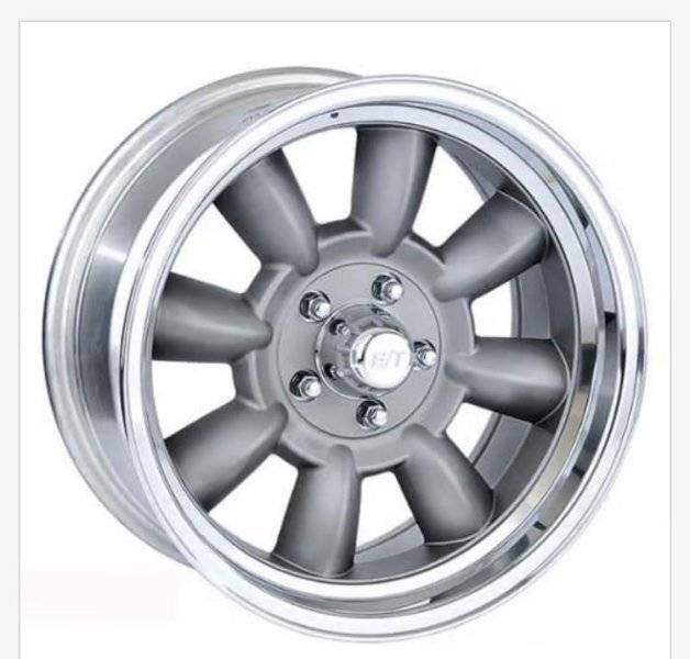

For the past couple of hours, I've been looking online for tires.
The front wheels here are 16 x 7 so the sizes for that width are readily available. I can get a 245 or 255 50-16 from a wide variety of manufacturers.
However.....
The rear wheels being 10 inches wide is great for filling out the wheelwell. The 16 inch diameter is the hard part. I can get drag radials in a 295-50-16 size but so far, I can't find anything street legal. Everything so far is ultrashort tread if any at all, or slicks. This won't be a track only car.
A 295-50-15 is readily available. The 17 and 18" diameter is better for 295 series tires too.
I'll keep looking. Maybe I will find something. There are Mickey Thompsons on these wheels right now but they are date coded 2013. I'm not settling for 12 year old tires!
I'm not sure if I will stick with these wheels or not. It might make more sense to step back to a 15 or up to a 17. The 16" diameter size seems to be an orphan.
