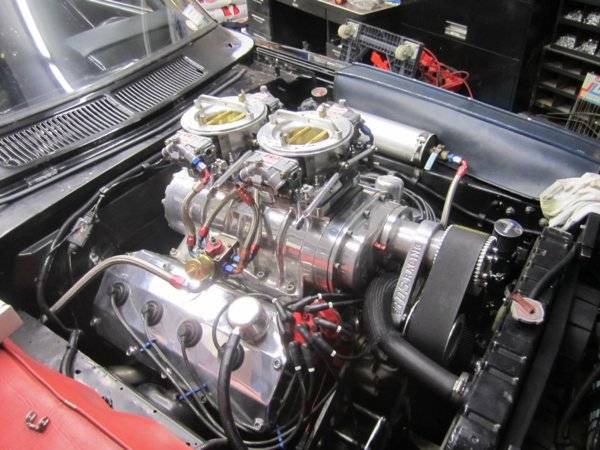

Ray Barton has been in the HEMI world a long time,but he is one of the most expensive.There are many good engine builders out there and depending what your goals are will help determine where to go.
As long as you know what you want from an engine,and have a budget or unlimited funds,,,,,,,YOU CAN DO IT!!

Yeah that looks awesome. But again what’s the best bang for your buck,with AC serpentine system. I have been seeing just for a 500hp engine with efi 15,20 gs.

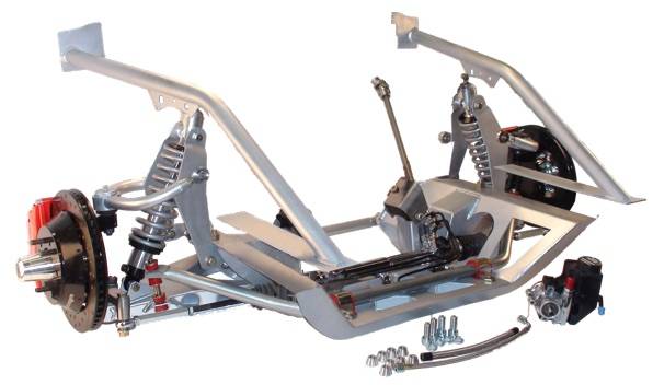

What kind of suspension r u running? I was thinking of running magnum force transformer
So what’s the cost on your engine ball park. Hell if you can help me find a bloc that would be awesome
I am running a RMS Front suspension on my 70 Challenger.
