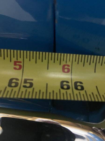

Hi guys, I'm trying to determine the proper distance between the lower grille support mounting surfaces for a '68 Plymouth B-bod. Does anyone have a known good grille support to get a measurement from? Or possibly a '68 that has enough of the front pieces removed, to get the distance between where the support bolts to the fenders?
I'm not sure if it can be accurately measured on a fully assembled car, maybe it can?
I'm also not sure if the '69s are the same in that area.
Thanks for any help!
Looking for this measurement:

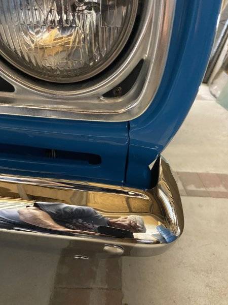

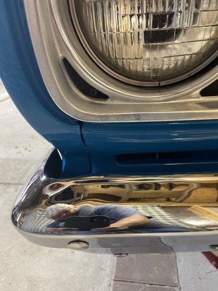

This is the only dimension I can get with the car together. This may help, not sure. I do have a car at the shop that is apart , I can measure it on Monday.
That works perfectly, thank you!
