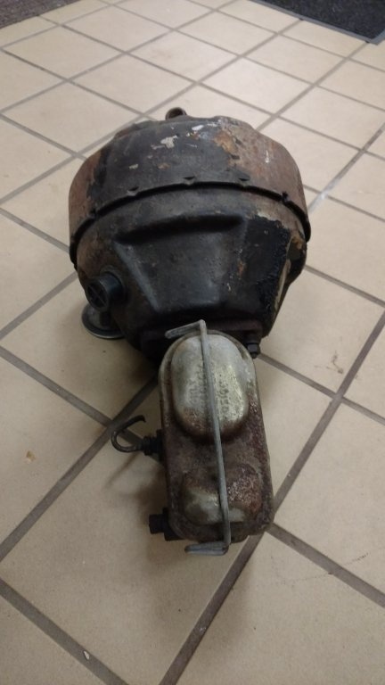

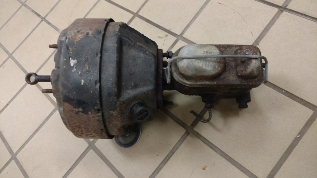

I have a used OE master and brake booster for sale if you maybe interested. Its of a 1968 B-Body 440cu in. Was working fine when removed.
