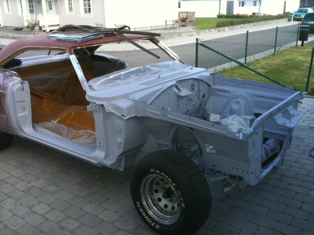

Finally got some primer on.
getting that primer on there makes makes that light at the end of the tunnel alot closer.

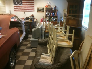

My mother in law are moving to town and her new apartment is being painted so you can guess where the furniture ended up...
Will be back in business in a month or so!
Ohhh that sucks man!! Sorry to hear it! Looks like you now have a shop TV, plenty of chairs to set your parts/beers on and a nice oak curio cabinet to put your tools in...lol
Good point Aussie, she could get heaps done in 8 weeks.....it'd help cover the storage fees.

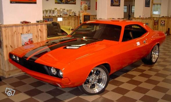

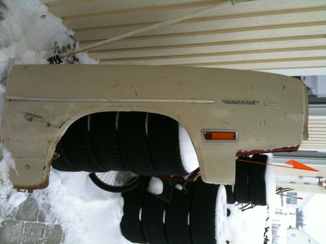

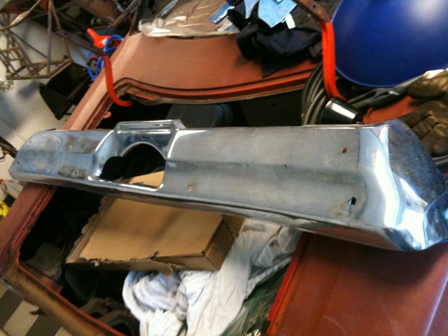

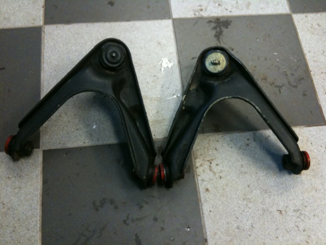

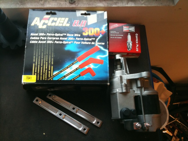

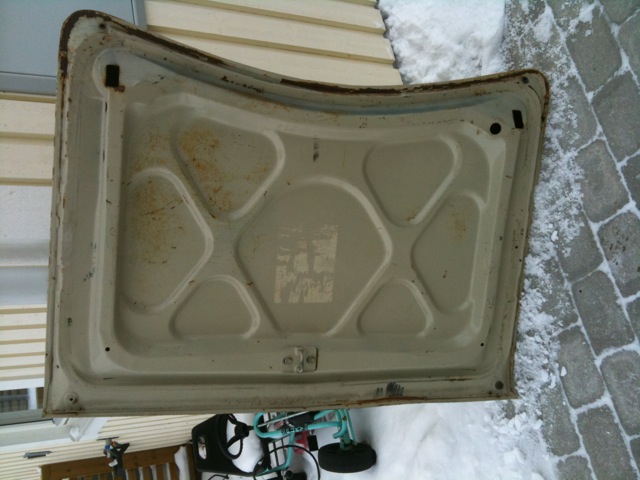

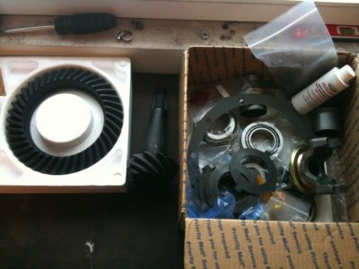

It has been some weeks now since I updated this thread, the winter came early this year so some of the plans has to wait until spring, BUT Santa was also early, got myself some nice parts. Found a nice almost rustfree front fender, trunklid, two wheel houses and an rear bumper here in Sweden. Then I spended some time on ebay and bought a new 3,55 gear with all the other parts, bearings, shims, suregrip discs etc. I also bought a new dress up bolt kit for the engine, alu. waterpump house, sparkplugs wires, fluid damper, plugs etc. Painted the engine a couple of weeks ago, starting to look good now. I have also decided what color to paint the car, you can see it on the challenger, it is an european color that looks really nice, a little more red then the V2 i think.

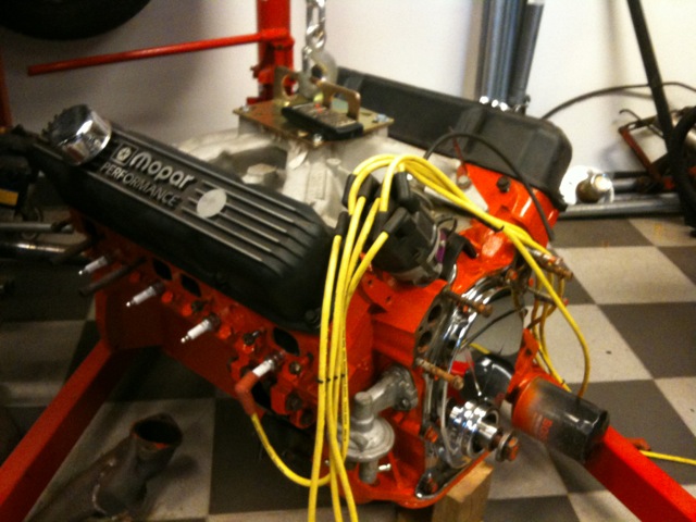

I have looked inside the engine now and this is what I found:
Crane Cam Part # 643801- Max Velocity Hydraulic cam- 278 duration intake 290 exhaust- .467 intake lift .494 exhaust- - good Mid Range Horsepower best RPM range 2200 to 5000 - valve float at 6500
Edelbrock performer (1407) 750, Torker 383 intake, 915 heads, unknown compression but fairly high on the compressiontest, looks like forged pistons with a dome if I look through the sparkplug hole. I can still see the cross pattern on the cylinder walls.
I also want to go with my HP exhaust manifold but will consider headders if it is needed. 2,5 " exhaust all the way.
This is the converter I have bought: http://www.summitracing.com/parts/HUP-24-25/
(I had a Hughes converter that I ran on the strip for 2 seasons and it worked great, GM 35 in a f-bird, 10.90 index, 10.14 with nos)
I also added a shiftkit from mancini to the rebuilt 727, they have changed some more parts since it was a 2 bbl 383 727.
Finally there is a 3,55 SG with 275/60/15 tyres.
I hope this makes a good combo, I am aware that the heads are not the best, I am also thinking about replacing the Torker 383, but if I continue I will soon end up with a new engine and this is what I got and I hope it will make a little more power than a stock 383, aiming for +350hp, how about that?
