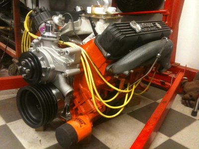

Starting of 2011 with a new picture of the engine, got the exhaust blasted and painted, let´s see if they are looking as great after I have started the engine... Waiting for the gasket kit for the waterpump and it soon will be ready to put back in the car. If everything goes as planned I will paint the engine compartment in a week or two.
Bought an complete exhaust system with hangers and tips from a 68 Charger in town, he has bought a complete TTI with headders instead. I know the tips are not the right one for a coronet but they looks great and it works for me.
Got 90% of all the parts i need to finish the car, so now it is up to me, better go out there and start sanding.
Happy new year to all of you!

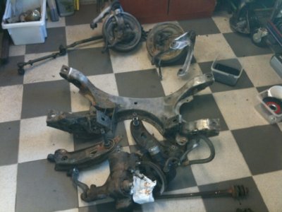

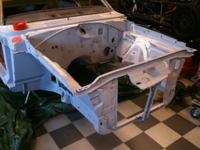

Got some work done, starting to remove the k-frame and torsionbars and it was in such a bad condition so I decided so do a total rebuild. Will order a complete front end kit and new torsionbars, already got a new disc brake kit.

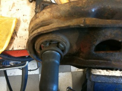

One of the bushings was on it´s way out...
I have also started to paint the undercarrige, first with epoxi primer and now with a black epoxi top coat.
To be continued...

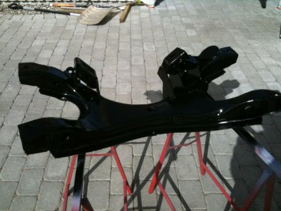

Another great afternoon in the garage!

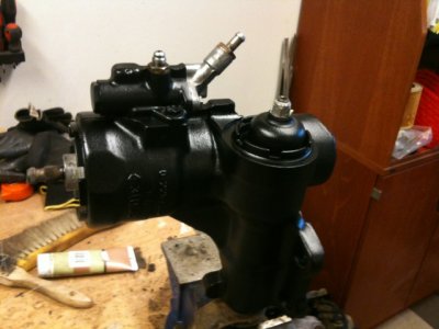

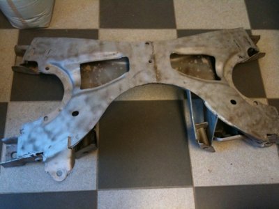

Painted the steering box, blasted the lower control arms and the k-frame, notice the lack of sway bar fasteners but I will weld in a new one, also planning on boxing them.
Disasambled the front brakes just to get some bolts for the disc brake conversion, it is a real dirty job! Everything is covered in grease...
Sent an email to PST and asked for a quote for a new set of torsion bars and a front end kit, let´s see if they answer.
If the weather stays good and the boss stays away I will get some more done tomorrow.

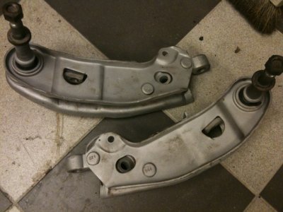

After I cleaned up the lower control arm I noticed one of them had a big backlash, is it junk or is it OK?
I don´t think a new bushing will fix that.
The other one is much tighter.

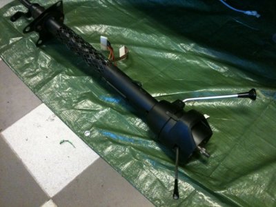

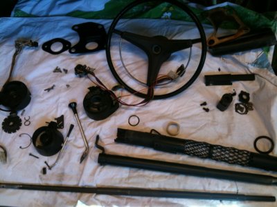

Found out that the only thing I had not teared apart yet was the steering column, so I disasamled it, gave it some fresh paint and some new grease, will try to buy the lower bearing (if I can find it in Sweden and perhaps a new steering wheel, found a 13,5" walnut wheel that I think will be great.
Any ideas?
Not sure, but I though I read that you were intending to box the control arms?
I wonder could you pinch the halfs together tighter with clamps before you weld on the plates?
That should tighten things up in most directions...although there is still some wear there I guess.
For my project I have 4 to choose from, but ALL mine are rusted SOLID!!! :(
Hey Swede, looking good. Those lower control arms are fine, when the weight of the car is on them that movement is taken up. The bushing goes inside the round part and the shaft inside that, your rubber one looks a bit crumbly. When you hear about boxing the LCA it keeps them from spreading during extreme driving, during normal driving the strut rod keeps everything in place and the arm moves up and down riding on the rubber bushing. When you box them do as Black63 says and squeeze them together then push out the shaft and replace the bushing inside. Did you get the steering, shifter issue sorted out?

Coronet 500 and Black 63; thanks for the tips, I set them up in the wise and most of the back lash disapeared, will be great when I get the plates.

AND, got some paint on the k-frame and some other parts, have not decided yet if I shold order the front end kit from PST or from Mancini racing, if I go for Mancini I can get a set of 0.960 torsion bar and some other stuff as well but I don´t know the quality of their bushings. Anyone?

Swede, Mancini offers Moog parts and you should not hesitate to order from them. They have been around for decades (Mancini has) and they don't sell any junk.
