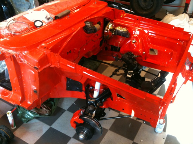

Got some work done today, front end is ready to roll, the only issue is the grease nipple on the tie rod that is close to the torsion bar on the pass side, lets see how it looks when the car is back on the wheels.
I also made new brake lines in copper nickel, found a bit of spiral core that I pulled over the pipes near the wheel house. Looks like original, just for fun.
AND I did not forget the seals on the torsion bars but it was a close one...
I have put a lot of time making sure all threads are cleared with a thread tap and I used a wire brush on all old bolts, than a little anti seize and the bolts run in by hand and you can get the right torque. It takes time but it is worth it, it is so fun working with fresh parts!

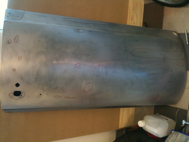

Doors totally stripped and all (almost) old paint has been blasted and wire brushed off. One door needed a lot of metalwork, it is much harder to pull out dents in this car if you compare to newer european crap, they are like beer cans. Found some rust in the lower corners on both doors but not so much as I expected. Will try to get som primer on today and mayby some top coat on the inside, I will wait with the topcoat on outside until I have installed the window etc. To be continued...

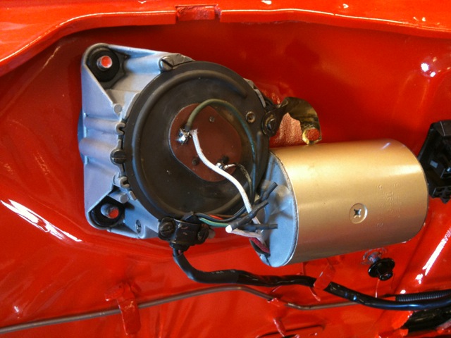

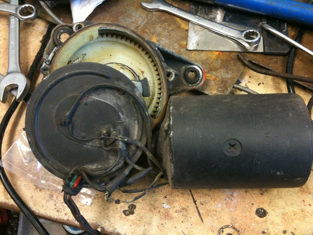

A minor update, the wiper motor is ready, I dont know if it will work, but it looks nice! A before picture in the bottom.

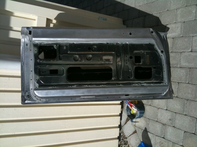

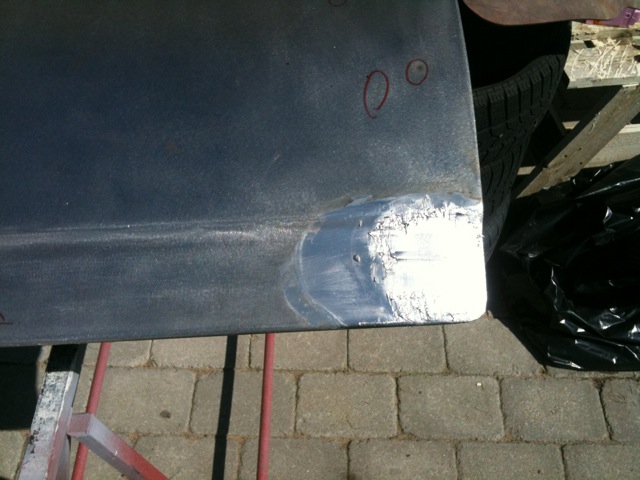

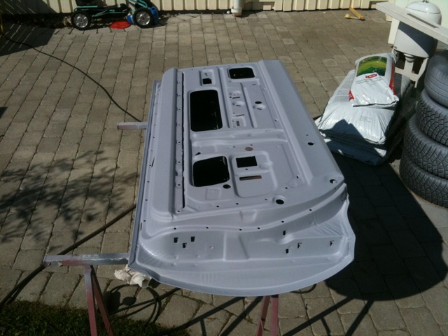

Then both doors are blasted and primer is on, did a lead filler job for the first time and it was fun, can imagine how hard it must be on a vertical datail...

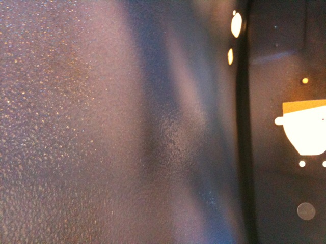

Also did some rust protection, the thick one is violet at first and when it is hardened it turns black! It will also dampen some sound and rattle.
Will start to fininsh the door tomorow with "some" bondo, it will probably take me a week...
I was thinking to hang the doors on the hinge for easy assembly and not to scratch the paint, is it a good idea or is it better to assemble them on the bench?

3 speed wiper test‏
Bench testing procedure.
Test #1(Hi speed)
Connect jumper wire from motor case to battery ground.
Connect second jumper wire from battery positive to BROWN lead.
Motor should run hi speed continuously.
Test #2 (Lo speed)
Connect jumper wire from GREEN wire to battery ground.
Join BROWN and RED wires together and connect a jumper wire from battery positive to them.
Motor should run at slower speed.
Test #3 (Park)
Connect jumper lead from GREEN to BROWN wire.
Connect jumper wire from red wire to ground.
Connect jumper wire from Blue wire to battery positive.
Motor should reverse and park.
(Depending on where the motor had stopped the park feature may have a full rotation or very short rotation
Wiper motor looks great Swede...Mine looks as rough as yours before you restored it. How did you get those wires and wire insulation to look so fresh? I have the same problem with missing insulation as well as it being painted over black.
As far as the doors, I installed all the guts before I hung the door on. Made it a lot easier to maneuver around it and get the proper angles to fit my hands/arms inside the door to hook things up.
