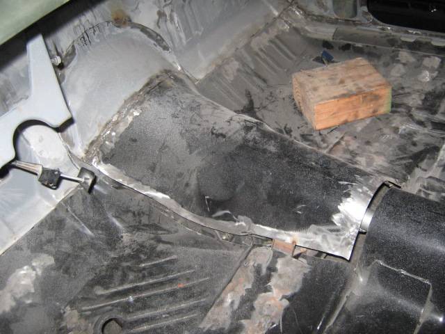

How much did you modify the trans tunnel (with some pictures, please)?

I expected the tunnel had to be more modified then you did…
This is a NAG1. If I had it to do over I would simply cut 3 sides and "roll" the hump to the passenger side then fill the space back in.
That’s what I was thinking to do. Or cut the tunnel in the middle of the tunnel in full length and at the fire wall and welding pieces of metal between the gaps.
