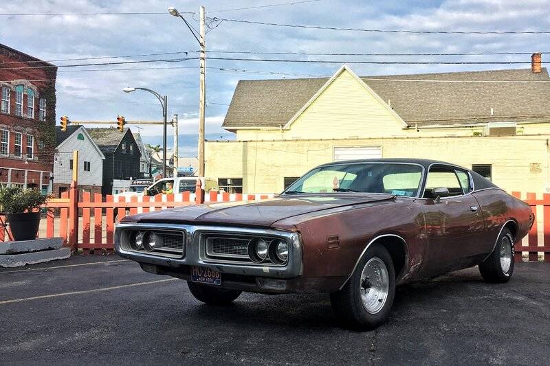

This is going into my daily driver 71 Charger so I'm not looking to build a drag car, just a good cruiser that can also respond well when I decide to goose it on an open stretch.
