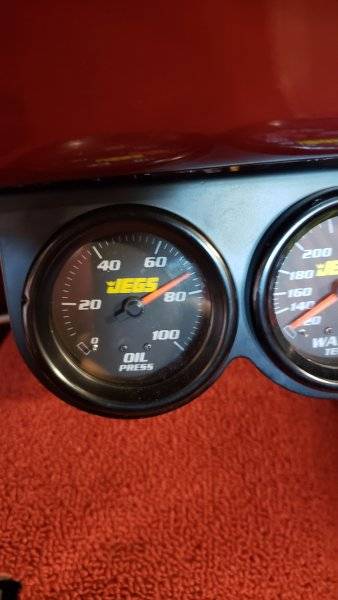

There is a new mechanical gauge along with the stock light. I did change the filter and it did the same thing when I took the car out. The engine builder is in SC so I would need to ship
it back $$$. Does any one know a thing about the relief spring? ....could this stick or fail? Next week I will spin the pump and do some checks ..... thanks for the help

OK went out and started the Coronet ..... oil pressure is fine..... some how when it warms up and you get on it... the pressure goes to zero ..... again would this be the relief vale issue?
Got me stumped ???

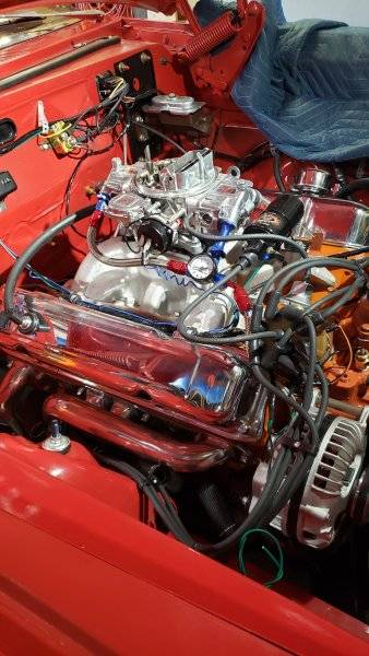

Ok … will try this forum once again. New engine in the Coronet that was built and dyno by CME. It had about 13 min dyno time with some full red line pulls from what the sheet said. Put the engine
In the car and started it with all new gauge and sending unit for oil pressure. Ran the engine in the car about 10 minutes. Had good oil pressure all around. Went to drive the car and as soon as I get on in first
Gear the oil pressures goes to zero and the light goes on. When I slowed down it regain pressure then the next acceleration it it lost pressure and never came back. Push the car back to the shop. Talk to the engine builder and we went over all the issues but he had no answers. I guess I will have to pull the gear and try it with a drill. My question is could this be something with the relief spring in the pump? Is the pump serviceable with the engine in?
CME told me to add 1-2 quarts of oil ….. did that with no luck. The brake in oil was chanced after it warmed up the first run. I’m not a mopar expert but any ideas would be appreciated. I really don’t want to pull this engine again.

The car did a 15 mile run with no pressure issues... it has both mechanical and stock light. No I am not a real mechanic. I decided to have a enginine builder build it and run it for me. There are not to many good machine shops near me and I also did not have a core.
