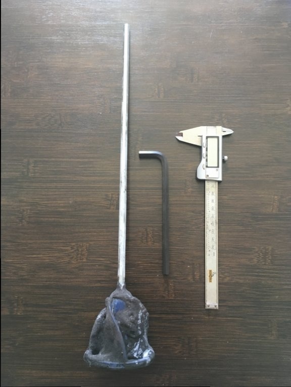

Can't find my tool at the moment and I'm trying to get up and running tomorrow.
What is the hex size of the oil pump priming tool?
Looking to see if I can whip something up that could work...

Made a priming tool with 3/8" steel line cut a hex wrench off and a piece of round stock and brazed it together. Cut the hex down by putting hex in a drill and used a bench grinder to cut it down to fit inside 3/8" tube.
I saw this last night before bed which is part of the reason I asked the size, turns out the hex shaft on the paint stirrer is 5/16! Perfect!
Saves me calling around looking to buy or borrow one.

LMAO, that's exactly where I got mine!
Local hardware store, about $7, half roll of electrical tape, $.39. Priming the new big block to 60 lbs - priceless
