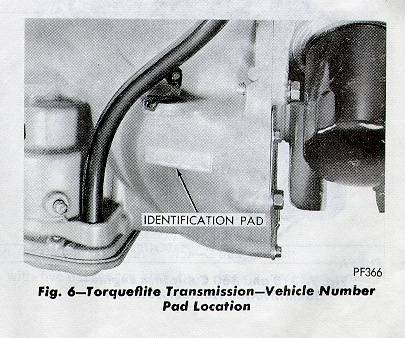

VIN location
Yes these folks are right... the number you found is the one near the pan rail (does not show the VIN), that one's just the trans part number

Just to put it all in a tidy package what the others said and added a bit:
PK = Kokomo, IN transmission plant
3410668 = P.N. for 1970 383HP 727
1 = (is it actually an "L"?)
3035 = Tuesday, November 18, 1969
2482 = Sequential serial number = 2,482nd transmission built that day
