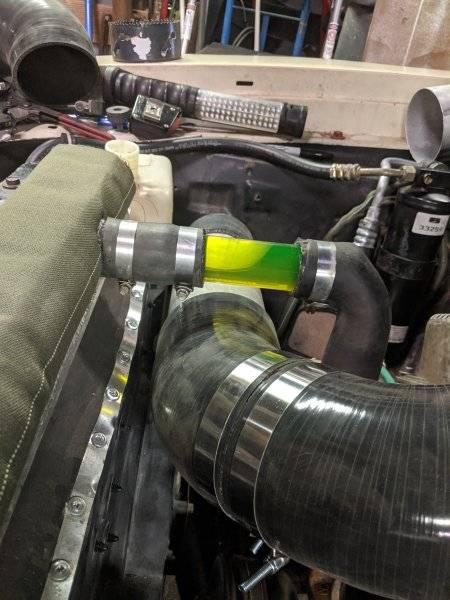

Hot cooling pressure test on your cooling system? Head gaskets?
one of these might help see whats going on
