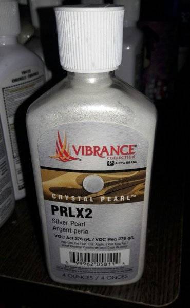

Going to buy paint. The color is light turquoise code jj1 1965 . But it isn't metallic paint. Can i mix metalliic into it ? Ask TCP Gobal , wasn't very big help. Base coat /clear coat paint. Thanks

I use PPG and when I used to paint motorcycle parts you can pretty much make any color metallic. I had a solid blue that I added fine aluminum toner to it to make it metallic. I’m sure where ever you’re getting the paint from have metallic toners or if you want to go wild, buy the powder.
What he said^^^^
You can mix in whatever you want, flake, pearls, etc. Go to your local paint supply and I'm sure they'll mix what ever you want... as long as you know what you want.
What is the desired result? Have you considered finding a similar color in metallic? If you ever have to do a repair, a home brewed concoction will be harder to match.
I would just look for a similar Cole that is a metallic. But if you do decide to add the metallic toner to the original formula, go lightly because the added silver will lighten the color up very quickly if you start adding a lot. Also record the formula for the mix in case you ever need to do a repair
