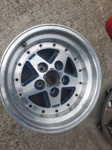

I've had these for quite a while. They are straight and they are very light compared to my WV's magnum 500's. The coating is toast on them and there is slight oxidation on the aluminum. I'm not sure if I should try and polish them or maybe bead blast them and then attempt to polish. I'd be willing to paint if I could get them to a uniform surface texture. Thoughts???
If those decorative bolts actually come out...
I'd blast em, paint em a medium dark gray, and put stainless bolts in.
Our resident powder expert won't powder coat used wheels, and advises against it.
If the intent is to polish, I'd sand them.
But I like 33 IMP's idea.
Leave the heavy magnums on or if the budget allows get some new wheel. Out of date and not a great style anymore

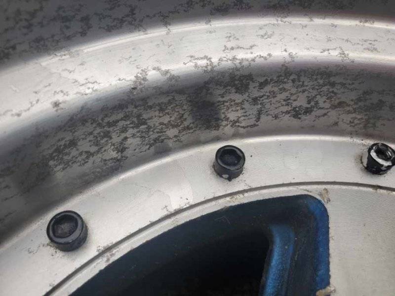

You have to polish out the deepest pit.(you probably cheat some). Looks like a bunch of polishing. Are all the wheels like that?

Well the car is 52yo so, being out of date isnt an issue and they are similar in appearance to a magnum 500. The right paint Scheme they would look awesome, 15x8 a plus also

Unfortunately, this is the worst

I agree. You probably will never be happy with what you get polishing them, and it's a lot of work. You could also sand them to a uniform brushed-look finish.
They are similar to a wheel. Not even close to a Magnum. A guy up here powder coats aluminum wheels all the time. They work and hold up great.
If you like the wheels, take them to a wheel refinisher locally. Most of the refinishers
have tracer lathes that copy-cut the wheel and only take about 0.005 off at a pass
and they will clear powder coat them. They'll be like new wheels. Of course, you'll
have to ask them to remove the cap screw heads.

If you do choose to blast them, be sure of what type of media will be used. Regular bead blasting will roughen up the finish a bit.. good for cast intakes but not what you want on aluminum wheels for a smooth & shiny polished look. There are other options for blast media, just something to keep in mind.
I would find a local outfit that does vapor blasting. I use it on vintage motocross bikes aluminum cases, hubs & other parts. I have a local guy that does it cheap. Then you can decide if a polished, painted or powdercoated finish is the next step.

15x8 so a good size. Now minimize the cost and effort to see if it pans out. I believe that the finish problems are the factory powder coat clear failing, not corrosion.
Remove the fake bolts, media blast, and clear. The finish should be a bright grey. You might like it. Paint the bolts wheel color.
I would suggest you might like it better fogging some silver base coat, then semigloss clear. Detail in the black area. Main thing, minimize time and cost.
