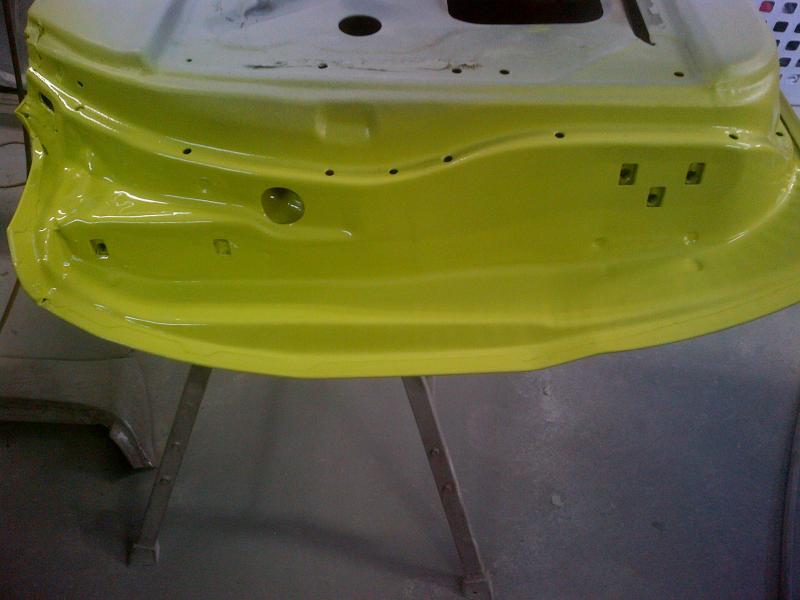

I have,and I'm doing the same as you. I thought it was good,covers well. I'm using PPG for the panels,also from TCP. IMG-20140121-00152.jpg

That looks great what did you use for the clear I was thinking about the kustom shop
The picture doesn't do it justice,I used some Transtar Classic Euro 7311,I picked up locally.
