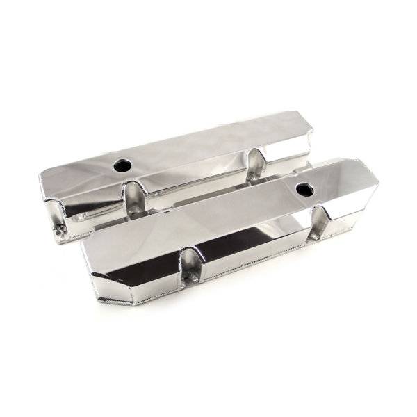

For better sealing and a somewhat stock look, use the cheap cast aluminum valve covers that are plain, no ribs or logos, and paint them with the engine.
https://www.summitracing.com/parts/sum-440350

I used the fabricated aluminum covers you can find on eBay and the just fit. Just the included rubber gasket was used and the baffles cleared fine.
