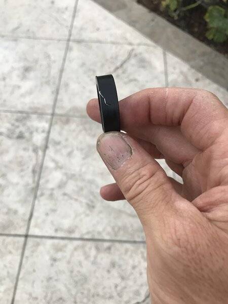

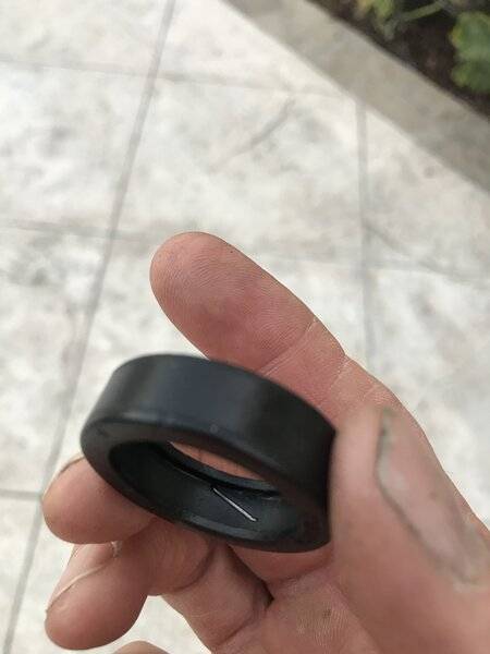

Cleaning up my steering column and rebuilding it. Just took the bearing out and the rubber boot around the bearing has a staple through it. I assume it’s not supposed to be there?

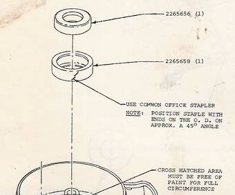

Comparing the drawing and the foto, it looks like the aftermarket one has the staple inserted backwards from the factory staple. Guess it doesn't really matter.
