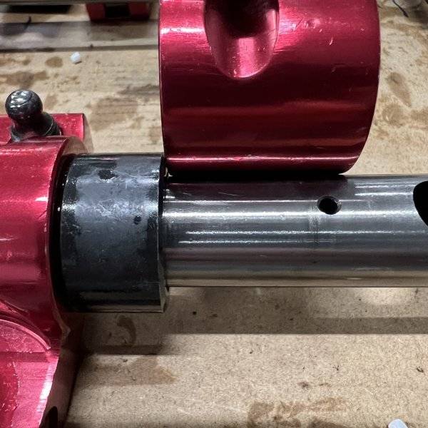

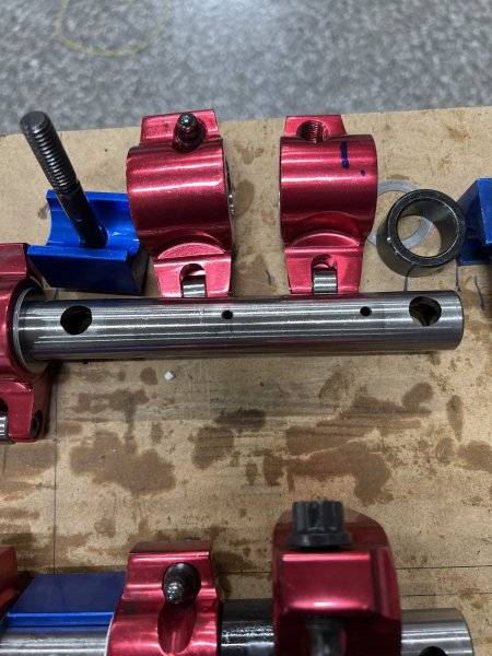

Pulled both shafts. Oiling holes were down. Both shafts are identical, holes offset to one side. All rocker bearings land midway over the oil hole or closer to the outside based on shims. Oil hole lands on one side of each rocker bearing (bushing?)
Not really sure what to do here, I’ve swapped the shaft end to end, same thing.

I would think the oil holes in the shaft would be in line with the prod adjuster [ or close to it ], so that the adjuster gets a direct squirt of oil. Holes look nowhere near where they should be.
Ok, so I’ve got our machine shop filling the old holes and drilling holes that center to each rocker.
Each rocker has a hole to oil the pin and the roller.
The shaft fills up just fine when priming or running. Oil pours out around each rocker side and spacer. But never filled the rocker body.
Looked at a bunch of new kits online and the holes all center to the body. So I hope this works.

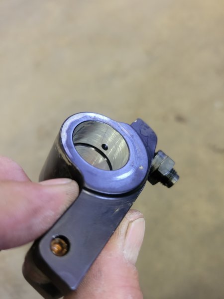

So the rockers have oiling holes to the adjuster ball, correct?
So the rockers have oiling holes to the adjuster ball, correct?View attachment 1480493View attachment 1480495

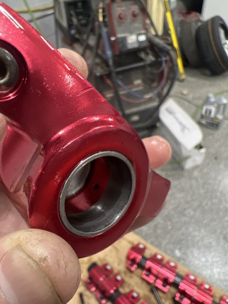

Yeah, the holes are there. One to the stud and one leading to the roller. See how the one in your pic is in a bearing surface? Mine have a bushing on each side with a .375” gap between the bushings with the holes. The oiling holes in the shaft landed center to a bushing or on the outside edge. Never really pressurizing the cavity.
Looking at their website and other models they have, all piling holes center-ish to the rockers body. Brand is Speedmaster.

Correct, with the exception of added shims. Just about every other rocker is on the edge of an oiling hole. Would explain why I was seeing oil gushing out in between the spacers.
Your last word in the above comment explains your problem. Awesome Chinese Quality there... You should be able to buy some quality hard chrome rocker shafts with the "Bananna Grooves", and that should allow the rockers to oil.

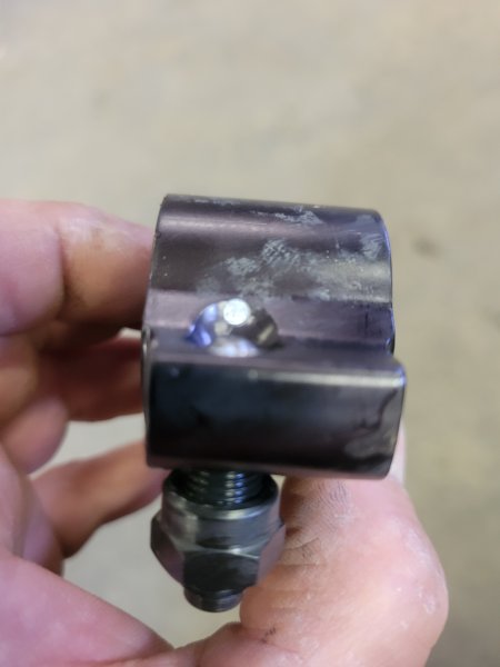

There is a similar thread on A bodies where the rockers have scuffed the shaft. Pic shows where BOTH rockers have scuffed the shaft, but only ONE oil hole which looks to be where the spacer sits.
