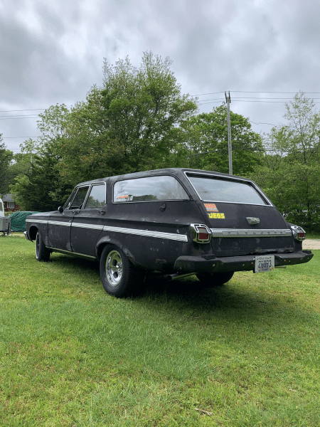

I'm looking to stiffen up the chassis on my 65 Belvedere wagon. Is there a big difference in the dimensions from 2 door to 4 door wagons? Just wondering how much mods would be needed.
It isn't a drag car. I plan on doing a lot of towing and hauling with it plus it's my nice weather daily driver.

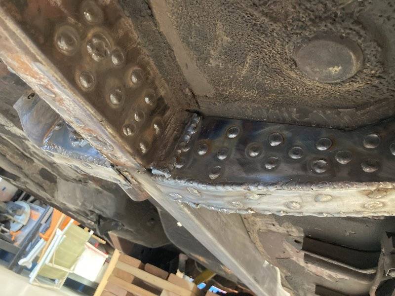

Since my floor had stress cracks and some other issues, I did 2x4 .120 wall rectangle. I ran them long and sleeved them into both the from and rear frame rails. Slit the rails, pulled the sides in with clamps/vice grips, rosette welded them plus at any seams/laps. Also made frames for the Procar seats to sit on instead of relying on sheetmetal. The floor will get filled in after I make up the new tunnel.

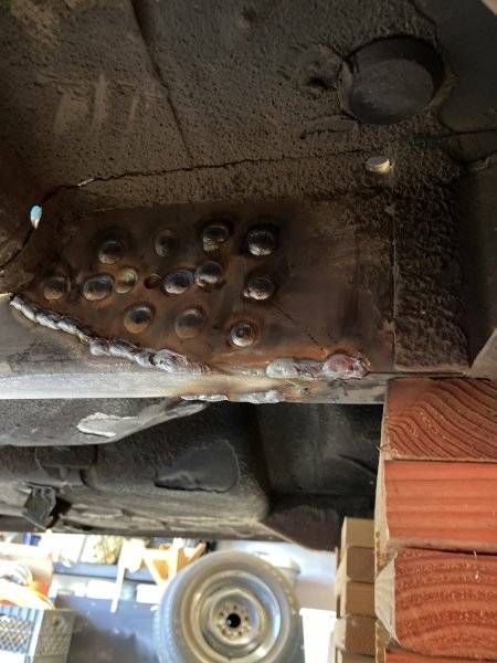

I put 2x2 ties on my '64 Savoy wagon; didn't have to cut the floor and they ran tight to the rear footwell.
No vibration or rattling.
Made a T for the front, welded to the t-bar crossmember.
Opened the beveled part of rear rails, slid the ties in, plug welded and welded sides & bottom.
Really stiffened the car.
The extension to the rear of my units is so I have a nice solid tie in for the spring relocation thats coming soon.
