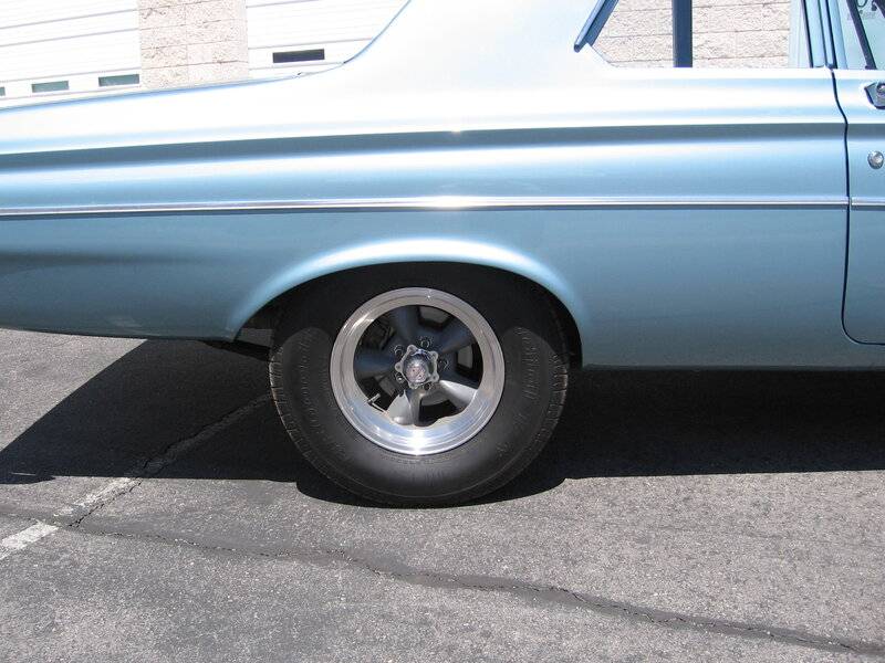

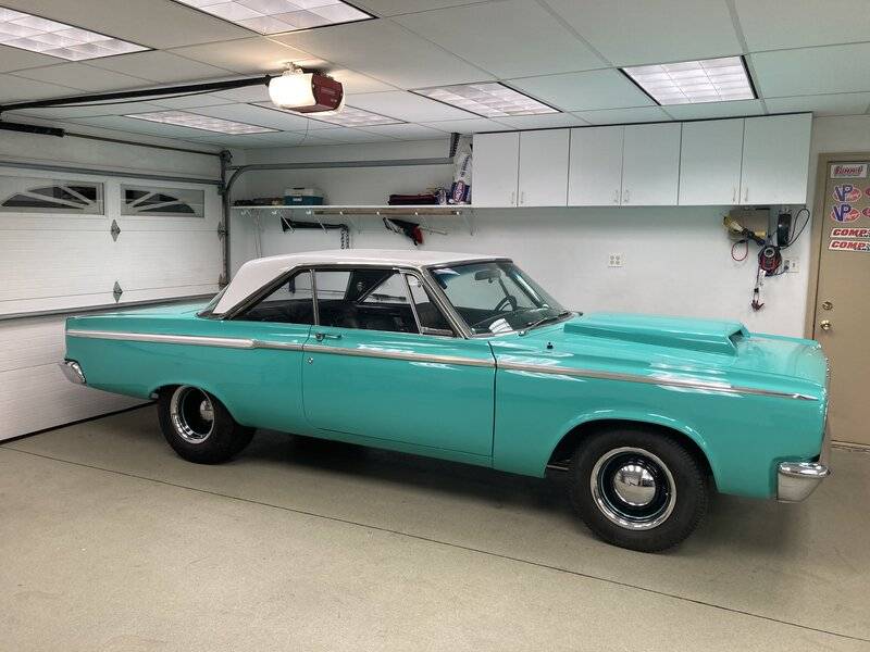

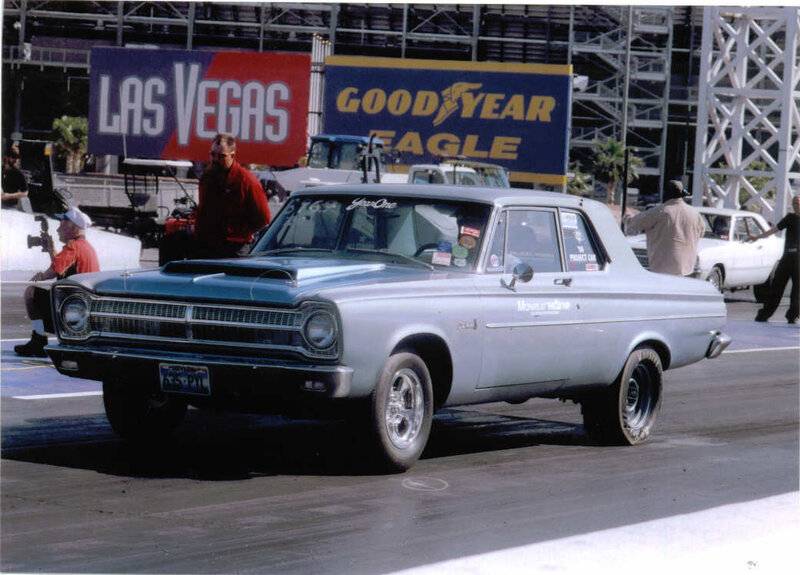

I run the 3400 lbs springs,no blocks This is the ride height.30'' rear tires.
Also I ran 2 '' blocks on a 67 Dart full time drag car with 3000 lbs springs .
Depending on how much HP you throw at it, say 500 or less you should not have a problem (with blocks )as long as pinion angles are correct.
Is your car a automatic ?

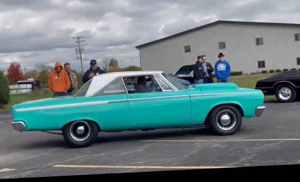

That is nice looking, thank you so much for reaching out.
My car sits a little lower yet.
I run a 29/12.5. 15 Hoosier. But I am putting a 315 Mickey Thompson ET street on it this winter and Torque thrust also.
Do you think the 3300 pound Spring would get me where I need to be?
Is there a problem going that light (3300)?
Could you share any more pictures of your car? It looks sharp and Thank you

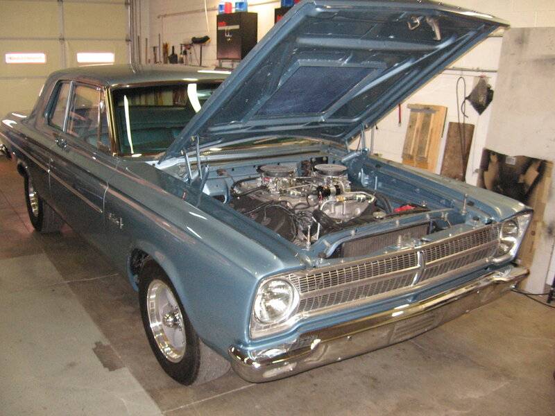

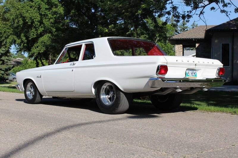

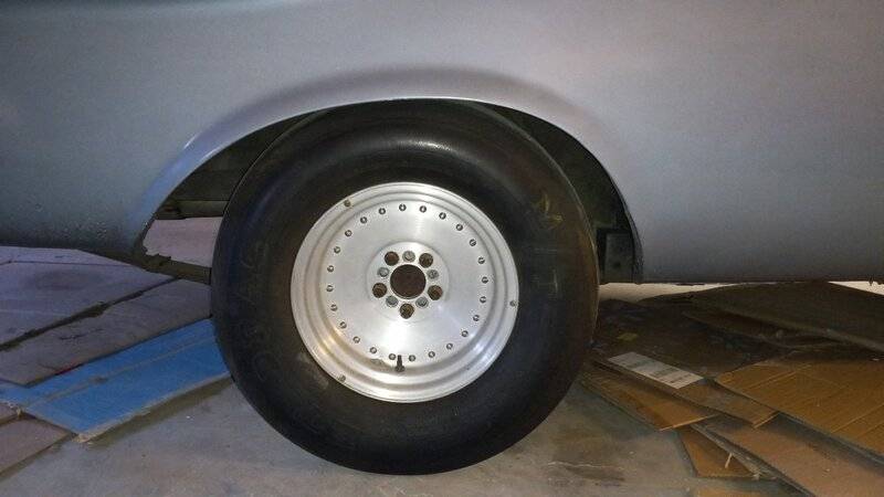

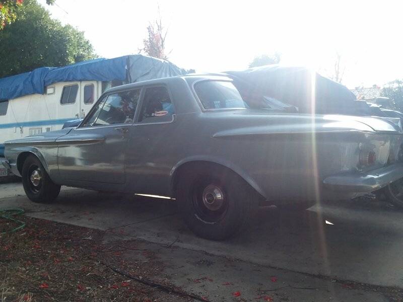

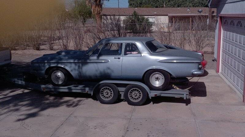

Here's mine. 456/457 in a 3300 lb 62. 10.5/28x15. Thin plate for pinion angle correction. These springs have about half the rearend lift (at launch at the strip, not body height) that the previous (stock 62, or maybe something else?) had.
Sorry the pic is deceptive. It has the front on jackstands, which strangely lifts the rear too. It sits more like the second pic, probably an inch lower than the wheel only pic

View attachment 1195234 View attachment 1195235 View attachment 1195236
Great pictures and information, nice ride and Thank you
