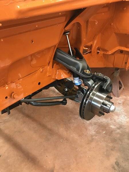

Eastwood Cast Blast & Detail Gray. Some parts you can leave natural and lightly coat with a satin clear. You can also order the paint that mimics the cosmoline that was used on the lower control arms. Restorick.com sells it.

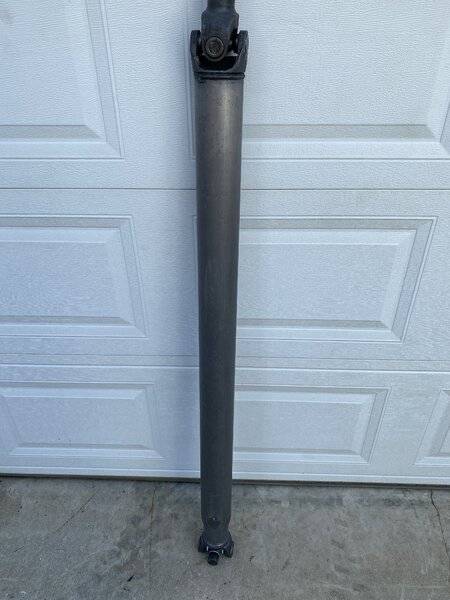

I used Krylon satin clear after soaking my driveshaft in Evapo-rust and it turned out great. Also did the same on my Z-bar/torque shaft.

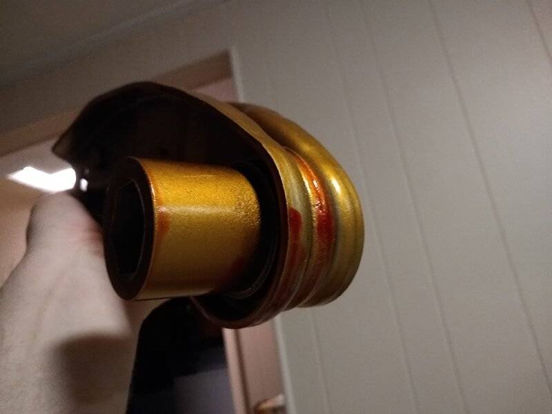

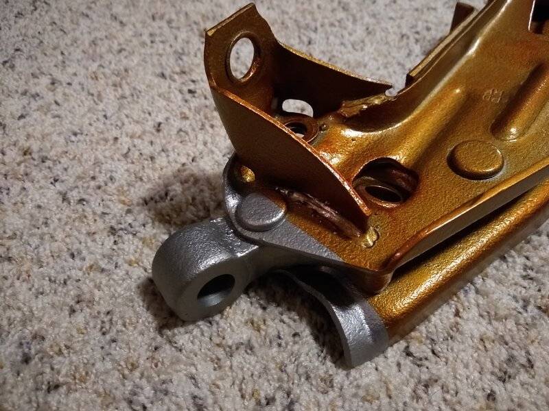

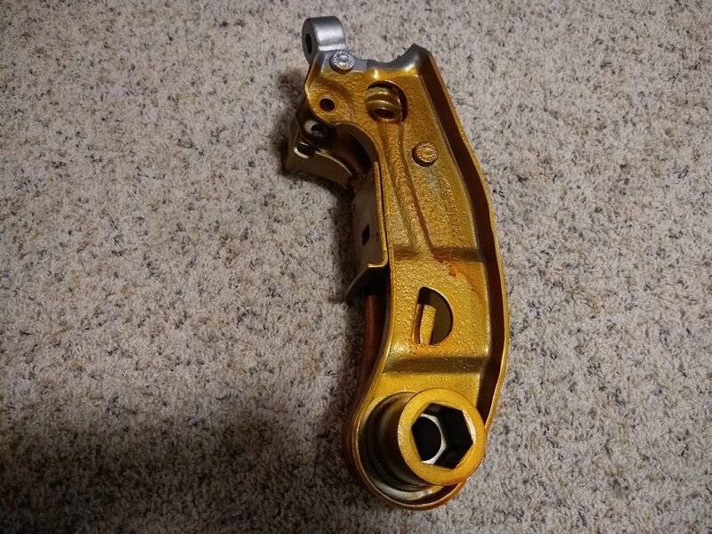

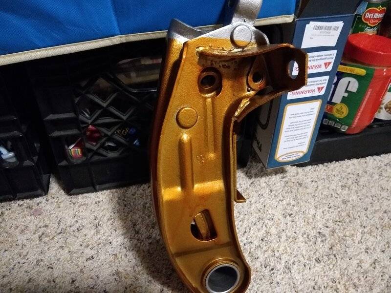

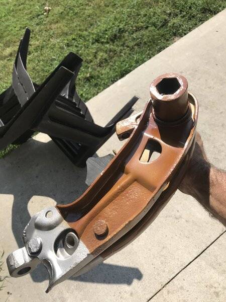

So I did puff can paints on my lower control arms. I blasted them, painted the entire thing with POR 15 stainless steel paint which I got at the local parts store, and then masked and hit them with the Krylon battery protectant. I ran the battery protectant to mimic being dipped in cosmoline
