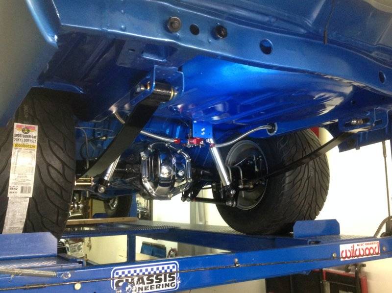

Bio all my cal trac stuff got put to good use under the winter project!
:thumbsup: :lowdown: looks beautiful!
