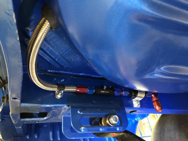

---Your feed & return go into the rail,are they run through the rail or go through and run the outside of the rail?
Looks like one going to each rail,did you put rubber hose around the line or does it just lay in there.Mine runs outside the rail.---
HemiItis I think you're asking about my fuel line? I don't have a return, just deadheading. But yes the fuel line runs through the frame rail, through the frame connector tube and out of the frame at the torsion bar crossmember.
