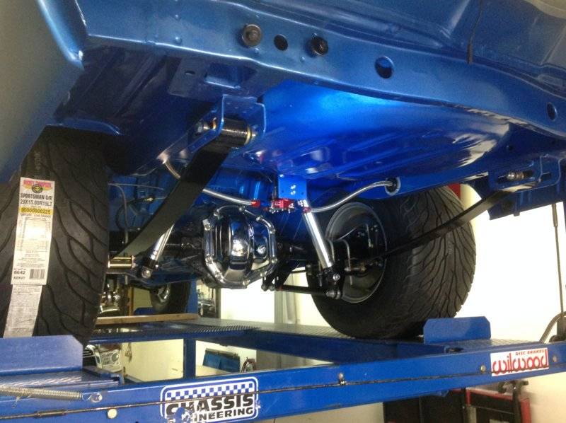

Bio, I'm going to use them for the first time in my car will be doing the bolt on like above. I see some help as the car raising in the back pushing the spring down should help on take off. Can't give you any better still waiting to get the damn thing together.

Yes, since vintagechromoly has me paranoid now about welding anything to my car, it's nice that there seems to be a completely functional, reliable method of attaching the sliders yet making them bolt on thus reversible.

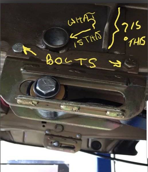

Any idea if those bolts go through existing holes? My guess is "yes" but I'd have to go look.

Tomorrow I can play like I know what I'm looking for and go see if the bolt holes are already there in the frame, presumably for something that gets replaced?
If any of you know if the holes that this bolts thru are stock, please let me know?
I wrote the ??s I have on the picture.
I wrote the ??s I have on the picture. View attachment 866982
The "what's this" is the factory body bracket, and the tube is for the shackles. The bolts held the slider in place. I was getting so much separation that the shackle would swing ahead as far as it could, after that is when the tires got yanked off the track. The sliders gave me more travel.
That's what I was thinking without going to look.
The bolts go through a bracket the guy made.
