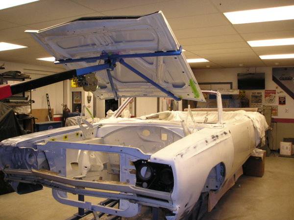

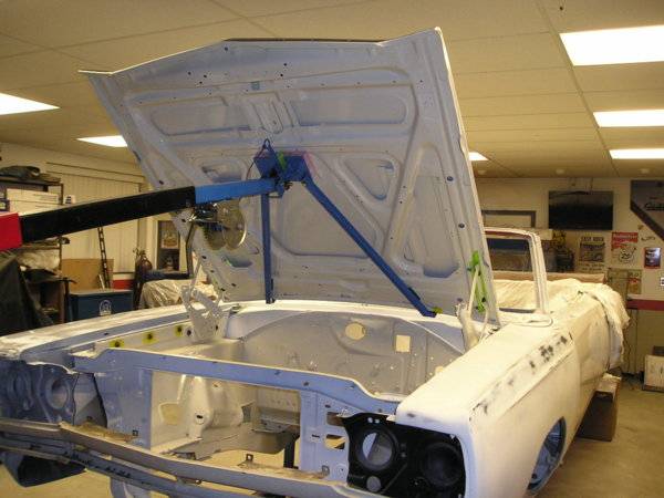

Okay ladies, gents and all ships at sea. It's time once again for everyone's favorite game show....
That's nice, but what the hell is it ?
Here are the rules : I post up a picture of some kind of contraption relating to our beloved Mopars and you have to guess what the application is. Wild *** Guesses are highly encouraged and as in years past, a correct answer will net the winner an all expenses paid boot to the head.
Good luck.
i have a cool thing that allows one person to hang a finished door with no sweat........ but It doesn't look like that
Petty blue Ice fishing tipup, is it autographed?
Looks like more work than its worth setting it up just to remove a hood the is propped up to begin with.
Its a hood mounted boat winch to winch your boat up onto your roof rack.
If it is a tool to help install a hood, by yourself, I sure could have used one last year. I had to wait till I had two helpers to re-install mine. No way you can do it by yourself without scratching someting.
Hook a chain to it and start cranking the handle.......it is a tie rod straightener!!
Looks a little like my drywall installation jack. ....but hoods look likely also
I'm starting to think it is a modified dry-wall hanging jack. :)
I bought one like this....
...and damn John, took you all of three seconds. :lol:

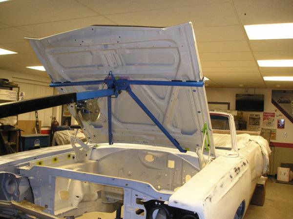

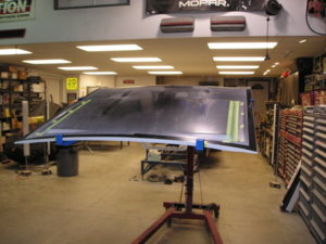

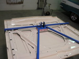

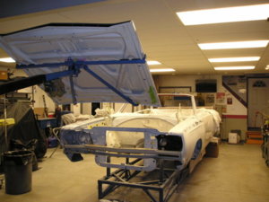

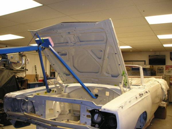

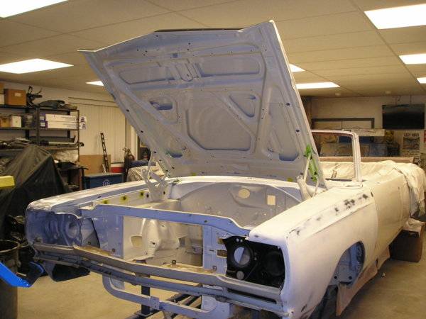

As I am a one man shop, the wife works second shift and the cats lack opposable thumbs (therefore of little help) it's nigh impossible to hang/remove a hood without damage all by my lonesome. I could enlist the help of the neighbors kid, but it could be weeks before he's vertical during daylight hours.

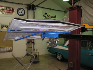

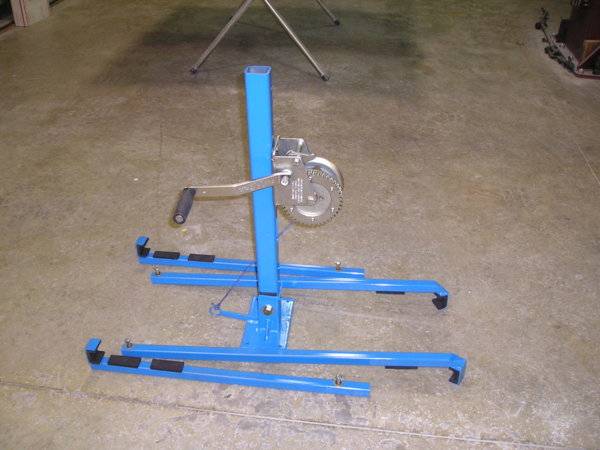

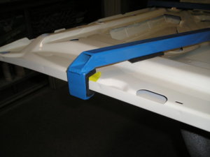

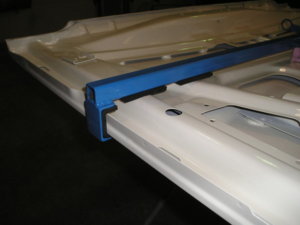

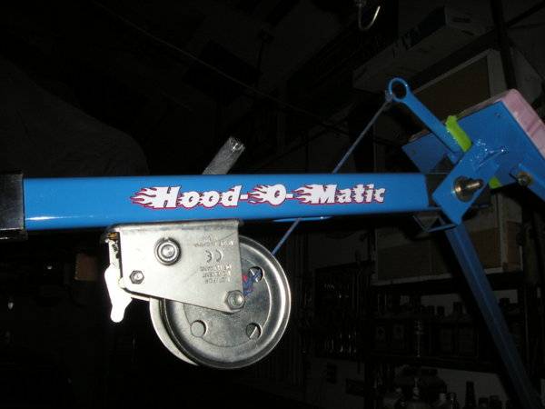

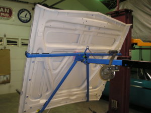

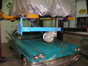

Gentleman, I present the answer to all your hood hanging prayers...behold the
Hood-O-Matic
It slices, it dices, it cuts tin cans and tomatoes with ease. Okay, okay, maybe not tin cans, but it does work damn well.
P1010582.JPG P1010584.JPG P1010585.JPG P1010586.JPG P1010587.JPG P1010588.JPG P1010589.JPG P1010590.JPG P1010594.JPG P1010595.JPG
Where you with this a couple of months ago? I waited patiently for the opportunity to have two extra people at my place to help install my freshly painted hood. I even cut myself some 2" studs to make the installation easier. Place them in the hood hinge bolts holes, then remove them one at a time while replacing the bolts.
Is that a Desoto?
