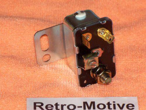

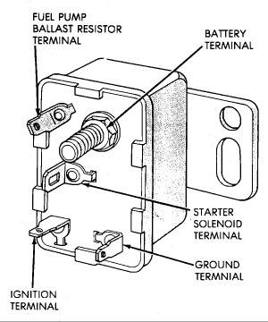

Start by downloading the shop manual for your car. They are available on this site I think. I dont have a link to it off hand but just do a search for FSM. You can find the entire thing for your car. Second It sounds like maybe a faulty starter relay. Its a small box on the firewall. Should look like this.
And should be wired like this.

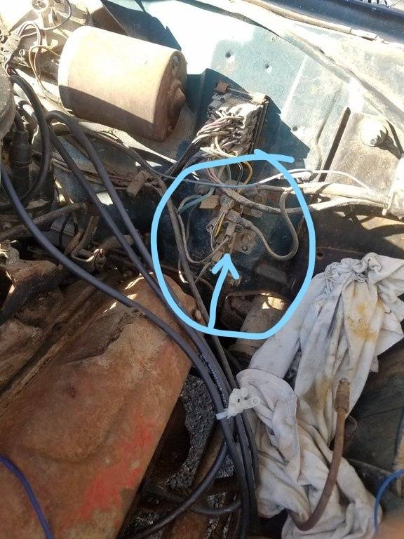

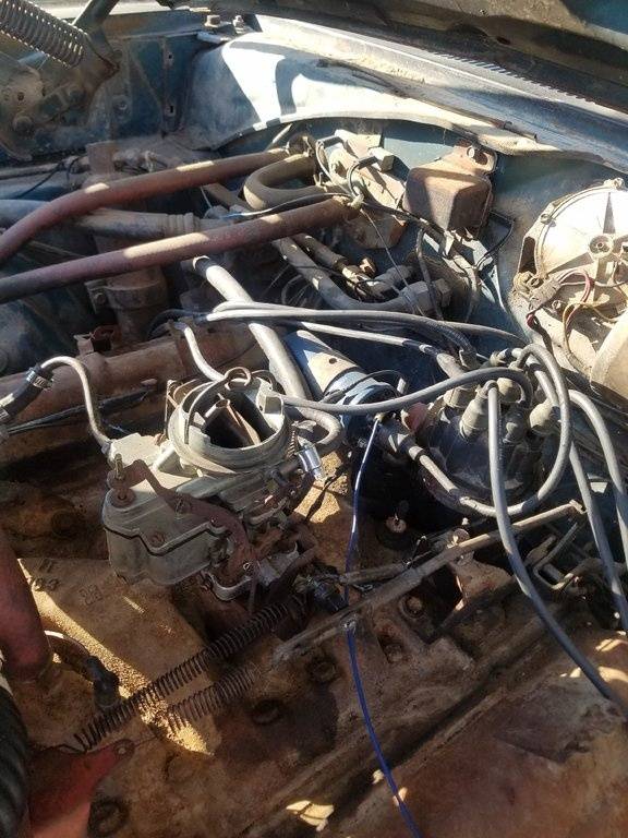

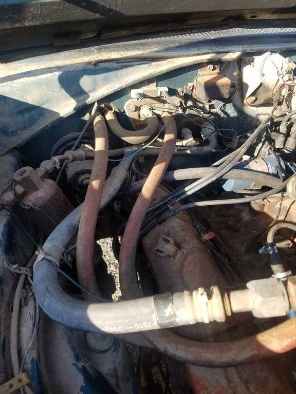

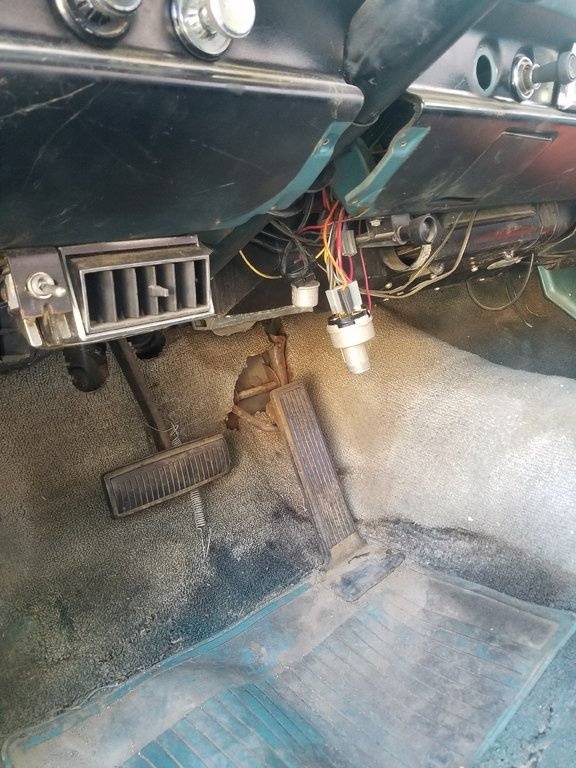

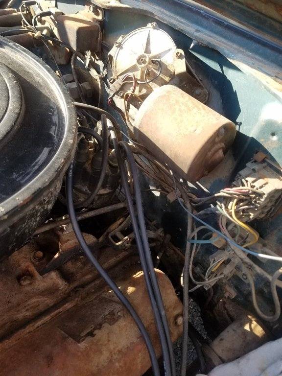

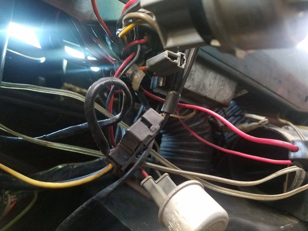

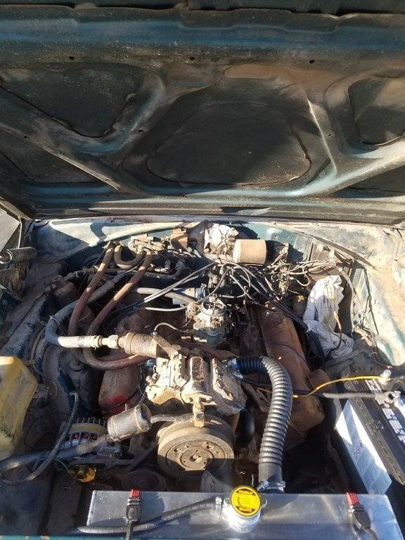

Engine bay pics will help
Here are some pictures of the engine bay and the wiring from the inside of cabin

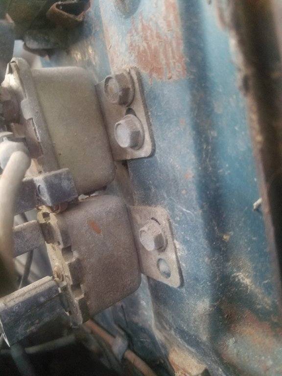

Is it me or does it look like it has 2 starter relays on it? Can you take a closer picture of this area in the first picture? Here is a cross site link to the shop manuals.

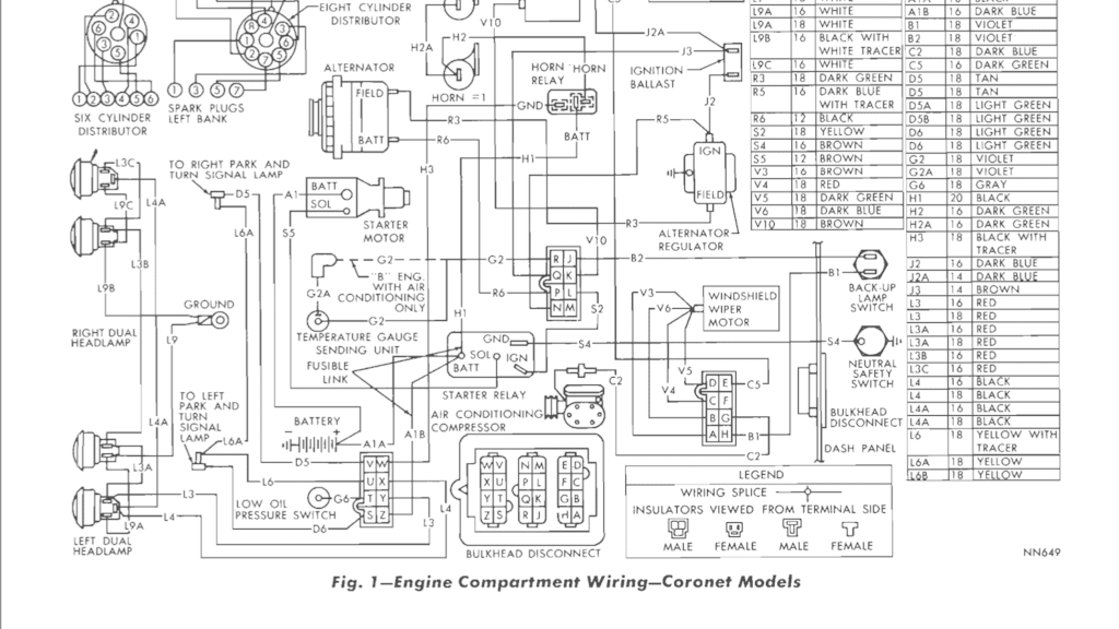

Here is a 66 coronet under hood schematic.

Nope it's not just you, looks like 2 to me:realcrazy:. I'd start with figuring out why there's 2. As for the car continuing to run after the cables were pulled, the alt is often connected at the starter relay so it would keep the system hot as long as it's running.
That 2nd(lower) "relay" is not setup like a starter relay; looks more like a terminal(?) block of some kind.

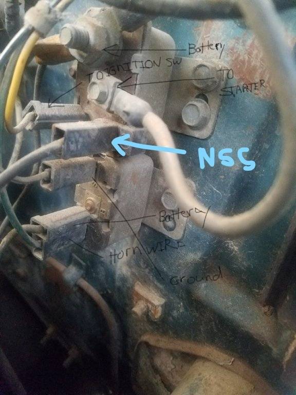

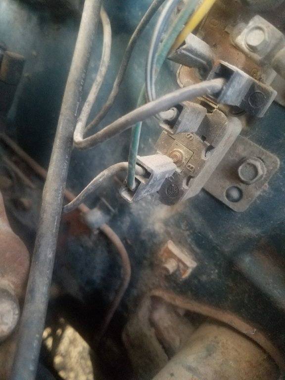

Yeah was thinking what it was because the
top one is the starter relay but I don't know what the bottom one is here are some pics.
Looking at the schematic above and the connections on the lower one it looks like the horn relay. How close are the horns/horn to that relay? I believe thats what that is now that I can see the terminals. This will give you an idea of what each wire does on the upper one. You also have fused links in there, The relay is cheap I would replace if you have power to the yellow wire with key on. If you do not have power with the key on then the issue has to be either under the dash at the bulkhead connector or in the ignition switch. If you can start it with a key then I would say the switch is good. If not then You might want to replace the starter relay.
I can turn the car on with the key, the only thing is that it doesn't turn off even if I turn the key to the off position, do you think replacing the starter relay will fix that?
It stands to reason that when you apply voltage to the yellow wire via the key it engages the relay. When you turn off the key the relay should switch off. I would try that first they aren't expensive. Its very possible that it just stays engaged. If you follow the wiring diagram you can see the yellow wire from I believe L terminal that goes back into the under dash harness its the only wire that tells the car to start. The NSS neutral safety switch is a safe guard and should not be an issue. The other wires are bigger and are power supply and feed to the starter. And one ground. So I would swap that relay out with a new one and test it out. 12 bucks at oreallys.. sure beats hours of senseless wire chasing.
http://www.oreillyauto.com/site/c/d...58_4584&rpl=1&categoryRedirect=01833&pt=01833
