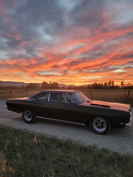

Here's a pic that I took Sunday that I thought was worth sharing.
