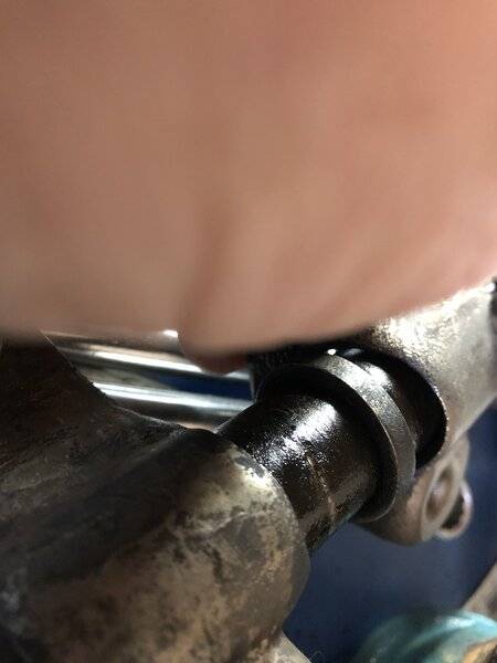

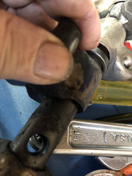

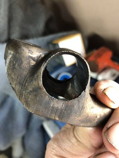

Pulled the 361 out of my 64 Fury and upon removing the rocker assemblies I found that each rocker was worn over a 1/4”. The engine only had a little over 61,300 miles on it but had very poor maintenance done on it. Had to consider the loss of lift due to rocker wear and overall performance of the engine after finding this problem.
Makes sense. Definitely something to look for when I disassemble it. What did you use to reference that kind of wear?
I checked the rocker assemblies when the engine was cold then loosened the rocker shafts until the rockers were free of pressure…… I was shocked how worn they were. Interior of engine was pretty bad including evidence of pure water cooling with no antifreeze which caused much corrosion on internals including passages in the block. New rocker assemblies were installed on a replacement engine making sure they were positioned correctly. The car had come from California via Las Vegas.
Some the rockers were actually worn oval shaped, I have photos on my computer which I will post so you can see what I mean. Hope this helps you!
Some the rockers were actually worn oval shaped, I have photos on my computer which I will post so you can see what I mean. Hope this helps you!View attachment 1315495View attachment 1315497View attachment 1315498View attachment 1315501
