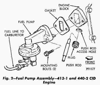

The pushrod should be 3-1/4" long. There is a pipe plug you need to remove to install or remove the pushrod. An eccentric on the cam drives the pushrod which actuates the pump arm. It seems as though all the newly manufactured rod wear. The original rods seem to hold up well
Ok. That makes sense. I was confusing the fuel pump rocker arm with the push rod. Very clear to me now with the explanation and illustration. I’ll check that out as well. Thank you.

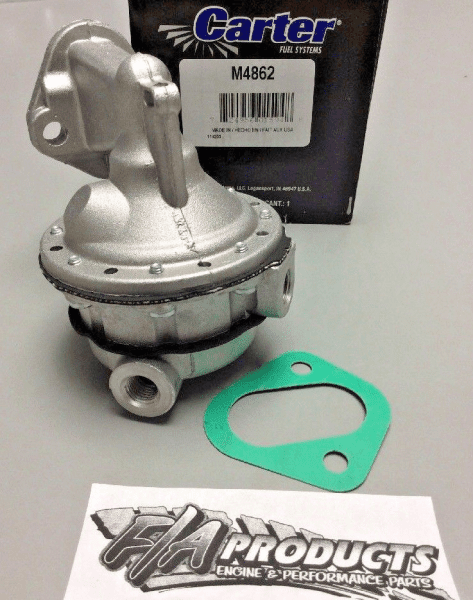

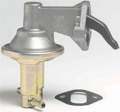

My existing pump is like the latter of he (2) you posted, with the threaded outlets. Looking at my existing one that broke it has far less quality of construction than the Carter. In particular the hinge pin on the pump actuator arm. On mine it has the pin pressed in and doesn't pass through the body like the Carter. If that hinge pin on mine was installed like I see on the Carter there would would have been a far less chance of the arm separating itself from the unit like it did.
The pump you have pictured is an M4862. I see some prefer the M6903. From the specs I see on Jeg's and Summit, the M6903 ranges from 5.5 to 7.5 psi. The M4862 ranges from 8 to 9.5 psi. I have an Edelbrock 1806, 650cfm carb and heard they can be finicky with pressures much above 6psi. Can you recommend one pump over another? Am I overthinking this? I work in a trade where these pressures would barely move the needle on our gauge LOL.
I would go with the 5.5-7.5 pump. I believe I bought the M6903 this year but havent had time to install.

New pump is in hand ready to go in. Came with (2) gaskets and got me thinking…
Is this thing supposed to have a spacer between the fuel pump and block mounting surface? If so, it would make sense why the old pump arm pin popped out as it wasn’t installed with a spacer.
I would think not,I never had a spacer on any of my BB.
Ok. Thanks. I dry fit it with the push rod on the low spot of the cam. The pump flange fit flush. I’d agree with no flange as well. Let you know how it sounds after it’s all buttoned up. Thanks again Dave.
Fuel pump replaced. It was definitely the culprit. Engine noise is gone. Thanks everyone for your input.
