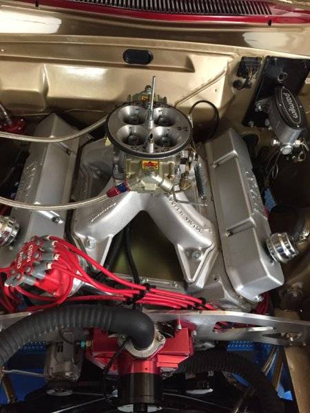

Best of luck Malex, be safe.Loading up and gonna get back at it. Car was working pretty good last time out posting a 10.12, 131.57 and a 1.38 60’. Hoping to better that this time out although weather looks to not want to contribute anything as usual.
A couple changes, up one size in jets all the way around, installed a billet meziere water pump and gonna give the stiff sidewall 10.5’s a try.
Fattened up the 1050’with 92’s. Ended up increasing the intermediate air bleeds a tad to clean up the blubbering at mid range. Had to offset the fan to get the meziere pump in.

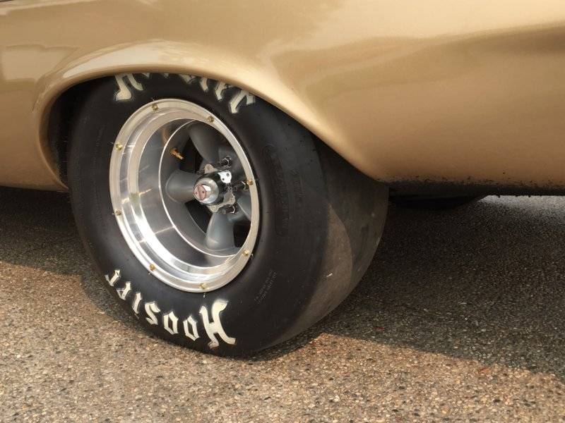

Trying the 29X10.5’s tomorrow. Exact tires that Mike Gaines runs. Will see if there are any “Gaines”. Haha.
Sliders lowered the rear some. I suspect they have helped in breaking into the 130’s 60’s.

---My slicks are MT 10.5w/s.they work well!
