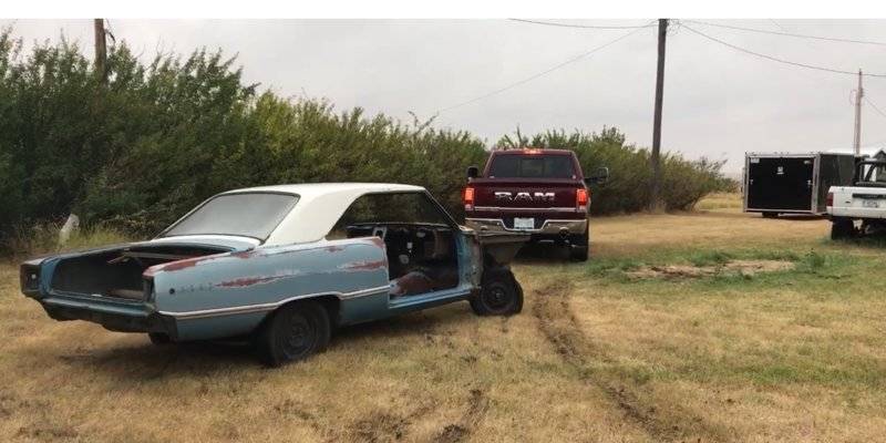

And the Dart is home, got lots to keep me active this winter, but not before the Plymouth gets it's rear suspension upgrades.
Had to whip the front end around to point it towards the trailer. 3 of 4 tires leaked air faster than they could be filled.
I bought the old Dart less motor/trans. I set it right back down in the same spot as when it was in the car. The fellow laughed, said he's gonna phone the mayor and report the car body as vanished. Small town humor. Love it.

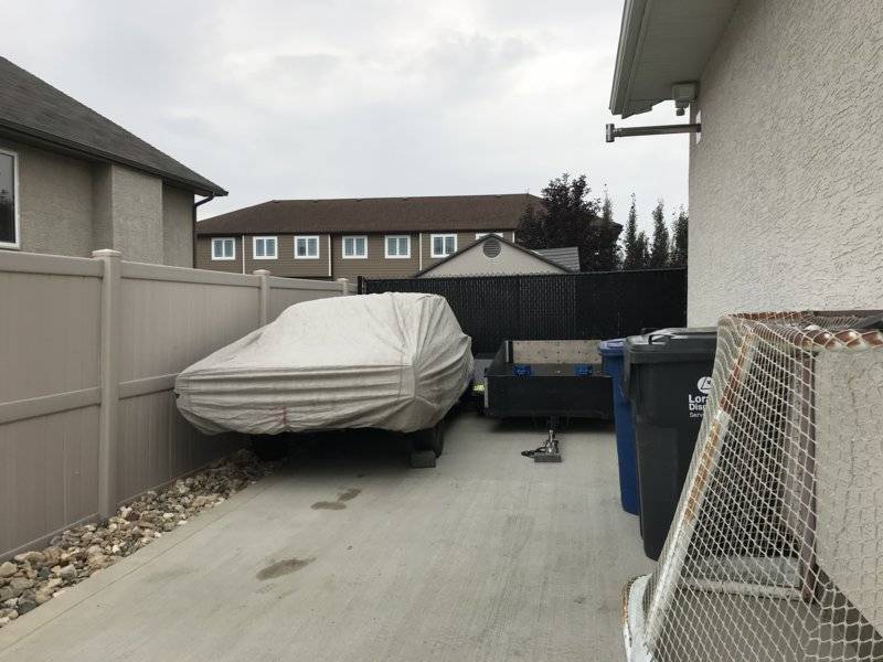

The Dart now sits and waits for awhile now.

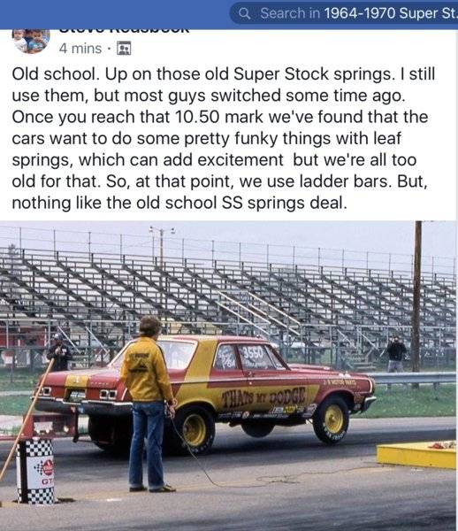

For quick reaction times, which is a major part of winning a race, it is just hard to beat ladder bars and wide slicks.
