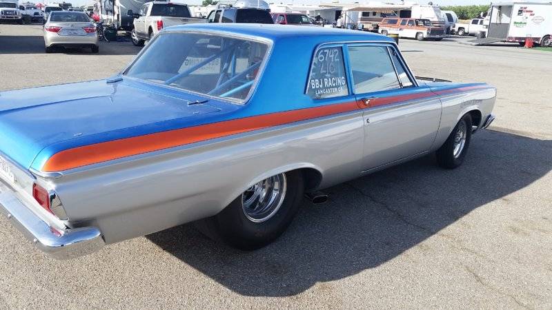

Nice work Malex! That sled is hauling the mail now!
Thanks LW. Yes things are falling into place now, Finally. On the very first pass this morning, I had not a clue what to expect, going left, going right or going up, and how much... but when I let the button go the car hooked solid, no bouncing around at all and the front came up and walked out a nice wheelie. Straight into the 9's. It was great, then came the worrying. So the air cleaner went on and 3 degrees of timing came out. That kept me on the safe side of 10.0 with 10.04's 10.06's etc, and going right to the semi final before going red. All in all, a great first day on ladder bars.

Thanks BDF6! There's been a lot of FBBO suggestions and advise along the way. It's been a group effort.
Now you have to take the permanent 10.something off your windshield. Congrats!
Thanks! 10.0 is the limit. Just a roll bar so that's it. I stepped over the line, now to be consistent just on the safe side of 10.0

Guys, I have to give credit where credit is due. Many of you guys helped me all the way along for the last 2 years and it is greatly appreciated. We have great assets here in each other at FBBO and we all win from it.
Regarding the decision to make the switch to ladder bars, which smartened the Plymouth right up, came from the advise and help of Superstock Racer. I reached out to him last August with my inconsistencies and suspension problems and he knew what I was going through and how to fix it. The triple adjustable bars and the complete set up all came from him and it worked exactly like he said it would. Thanks to Superstock racer this old Plymouth sure is working now!

No I'm not legal for 9's. My goal was to dip my toe into 9 second water a time or 2 and then run consistent around the 10.1 mark.

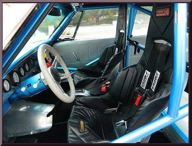

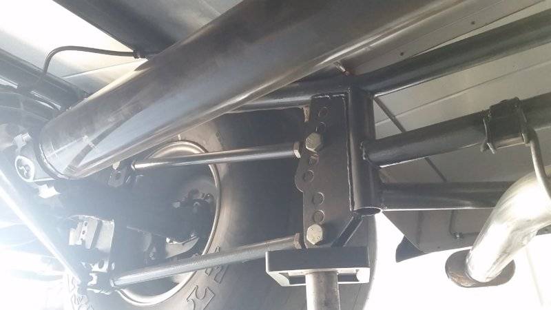

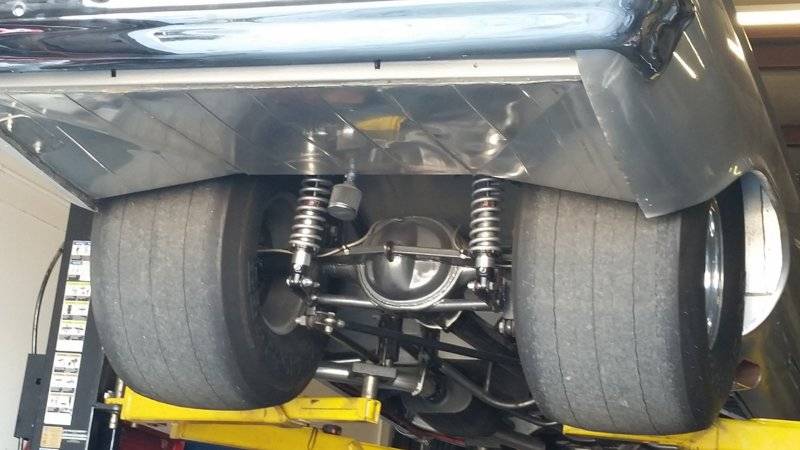

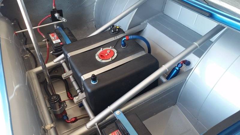

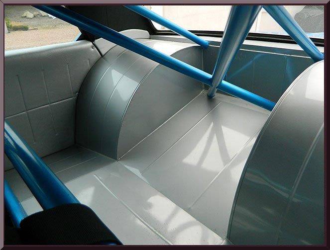

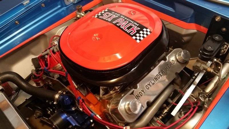

It certainly is a candidate for a big motor though, with an 8.50 certified chassis, 4 link, 9" Strange Nodular iron 4.88 3rd member, 15x15 Weld Wheels and room for up to 17" wide race slicks...and only weighing about 3100 lbs.
View attachment 773304 View attachment 773305 View attachment 773306 View attachment 773307 View attachment 773308 View attachment 773309 View attachment 773310
