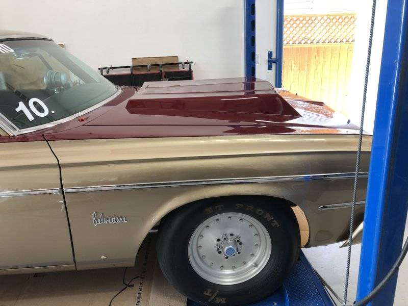

the steel hood is back on. So add about 35 lbs should make it safe but hood design performance will now show up.

Thanks Oldbee! Yeah, It's nice to get the hemi scoop back on the car. It's going to add about 30 - 35 lbs to the front, there goes the weight I just trimmed off, will have to give AAR a call I guess. The suspension works as good as it looks, thanks!

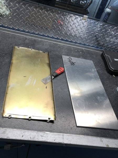

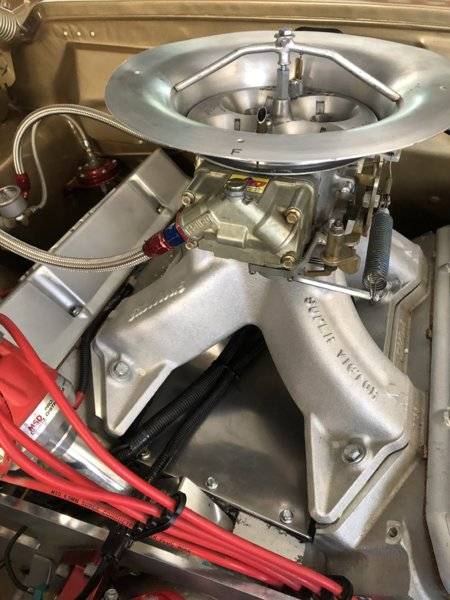

Last weekend at the track I noticed some oil on the valley pan under the intake. Sure enough, the flimsy pan cracked, like I have read that they do. Check it out. Cracked up both sides. What I did was tie a rag under the intake and it wick'd the oil, got me through the day.
And what you're seeing on the right side is my new home made valley pan. 1/4" aluminum.
The new pan is in place. I left .025 gap up each side and sealed it with right stuff. I'll build another one in the offf-season, a 2 piece.

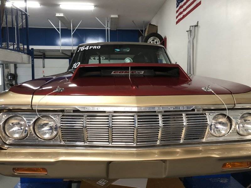

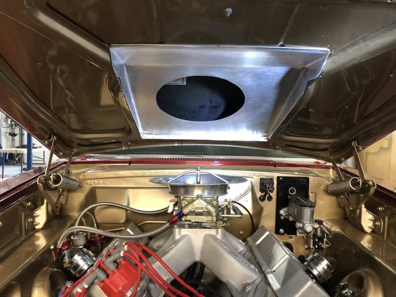

The steel hood came off the wall and got bolted on. I had a large hole made previously and you can see in the picture below the air pan that I fab'd up today. I built it so that it loosely fit in the hood hole, then I shut the hood and had it sit flat on the air bell to get the right angle. I marked it along the hood edge, removed, trimmed, reinstalled and riveted in place. As good as it can get, sits flush on the air bell with the hood closed and pinned. Will put a thin foam gasket around the outer edge of the air bell to seal it tight. The air bell radius is 12.750". Air pan hole is 11.500"

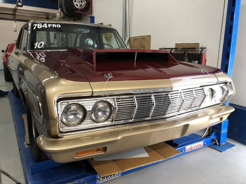

And a front shot looking in. A comp cam decal found it's way onto the front before it got riveted up into place. There's 2" space from the air pan to the top of the scoop.
So you know guys, this will be the official test. The Hemi Hood scoop verses the cowl hood that just came off. Any predictions???
