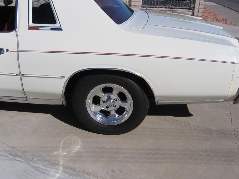

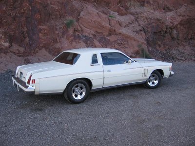

I ran 225-75-15 on a set of 7" wheels on my 66 Belvedere before. The car was lowered some too and they still handled pretty well for such a tall tire but the I also kept them nearly max inflation.
245/70/15 Cooper Cobras on a 8 '' wheel. Should be fine on a 7 ''. I also think a 255/70/15 would work if you really want to fill the space.
i got 285x60x15 on rear an 235x60x15 on front of 78 Doba
I currently have 255/60/15 on all 4 corners. Tires bulge on the rim so I wouldn't suggest ant wider on stock 7" rims
