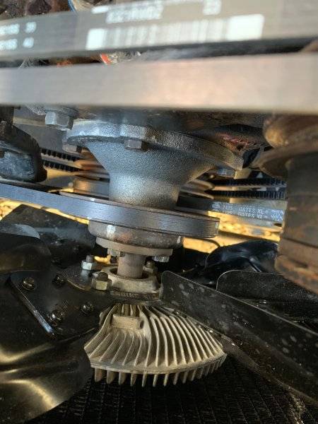

You said the fan already made contact with the radiator. Did anyone checked or looked at the fan spacer?

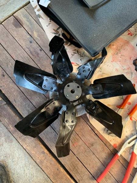

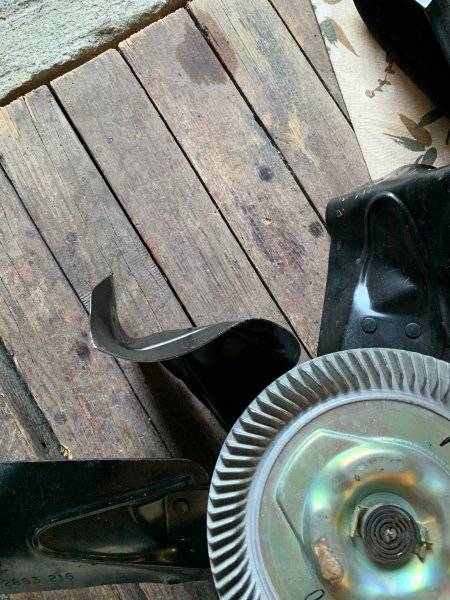

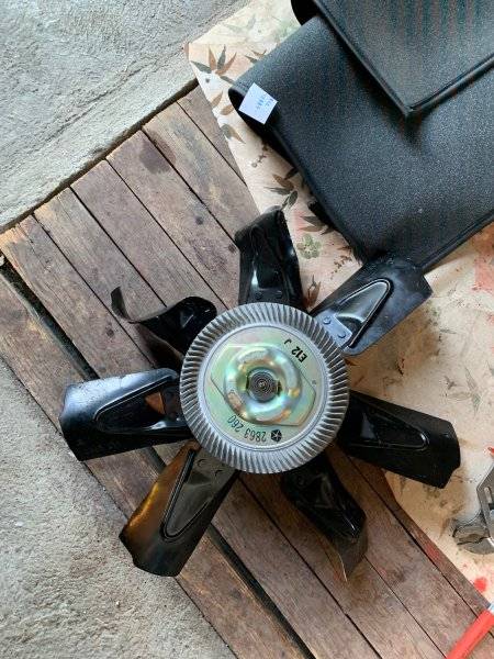

Getting that totally bent fan outta the car is amongst the hardest things i've ever done:
(It shoveld itself in the radiator core like welded to it)
The nos fan clutch at least cosmetically still looks fine, though.
I noticed the nos fan clutch is ~ 0.3-0.4" deeper than the reproduction unit that was in the car before.
So that's probably the reason why it completely destroyed the radiator core instead of just lightly touching it.

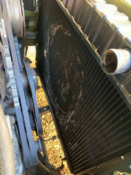

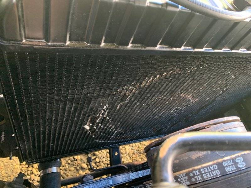

Look at my (brand new) radiator:

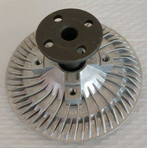

But look at the fan clutch, the bolt holes/threads for the fan and water pump do not line up. (fan holes wider out then water pump holes)
(Not my fan clutch, picture of internet)

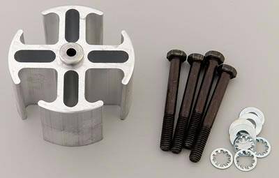

So it seems that this spacer does not really work without a fan clutch.
There must be an adapter or another water pump pulley to use the fan without a fan clutch?
You should have a good 1 inch, if not a more from the closest points of the fan to the radiator. Have you measured that? That one pic looks like it's dam near scraping it! Good Luck
