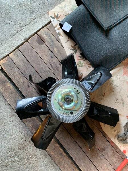

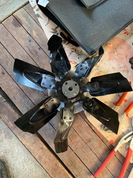

Today we installed this fan clutch
together with this fan:
and the wobbling / making contact with the radiator issue seems to be gone! I'm very happy about that.

So i got up early and started resolving the mess we created yesterday.

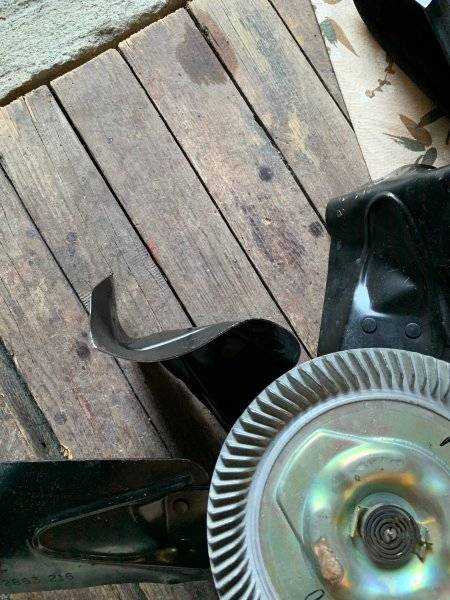

Getting that totally bent fan outta the car is amongst the hardest things i've ever done:
(It shoveld itself in the radiator core like welded to it)
The nos fan clutch at least cosmetically still looks fine, though.
I noticed the nos fan clutch is ~ 0.3-0.4" deeper than the reproduction unit that was in the car before.

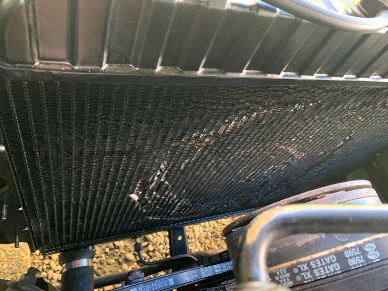

So that's probably the reason why it completely destroyed the radiator core instead of just lightly touching it.
Look at my (brand new) radiator:

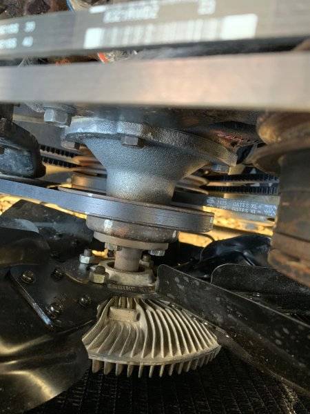

Well i bolted the water pump pulley back on and let it run at idle, i think its not wobbling?
(So it looks like the water pump or water pump pulley isn't the issue?)
Don't worry about the belt its a bit loose but it's brand new (installed it yesterday) and it just needs to be re-adjusted a little bit.
Its not squealing or anything, though.

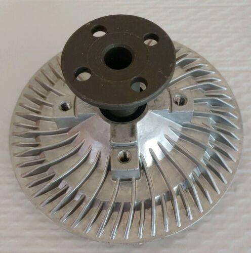

But look at the fan clutch, the bolt holes/threads for the fan and water pump do not line up. (fan holes wider out then water pump holes)
(Not my fan clutch, picture of internet)
So it seems that this spacer does not really work without a fan clutch.
There must be an adapter or another water pump pulley to use the fan without a fan clutch?

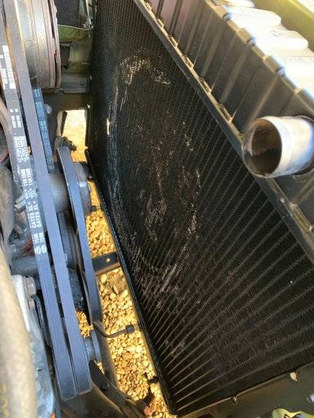

Looking at the radiator marks it seems to be that fan was on an slight angle (inwards at the bottom) changed a mates 318 to 440 and saw this, had already brought the shorter Hayden clutch , ended up to get better clearance with a std clutch and a 7 blade SB fan ( due to hose clearances)
