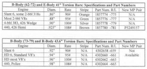

guys what kind of car are we working on, weight. rims, tires usage etc
I have 1.080 on my C body but the bars are longer
cop car bars on a 73 B Body are not too large- look them up
you can plug the grease fittings and just put them in when greasing or use a rubber tip
The torsion bars from 1973 will not fit the 1965-72 B Bodies from my research.
72 and prior are 41" length
73 and up are 43.6" length
I did not say they would fit I said they were not too stiff, could be even stiffer= your bar guy is giving you good advice
