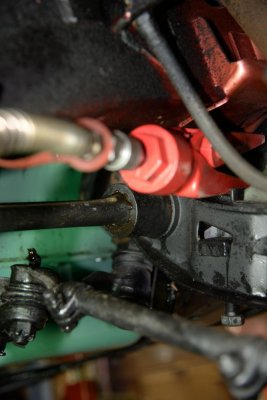

Getting them out is a snap. Getting them back in is, sometimes, a real hassle because the lower control arm isn't quite lined up and you need as second pair of hands topry it down unless.....................
you go grab the Porta-Power.
Put it between the frame and the torsion bar lever and spread the jaws until the flats in the anchor are parallel to the flats on the torsion bar. This'll help you re-align the two sockets and the bar will slide in easily.
BTW, If you go to the trouble of doing it before you pull the torsion bar, the bar will come out MUCH easier, too.

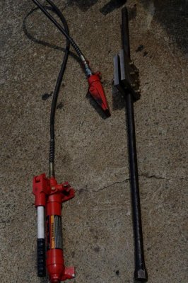

....and here's a home made puller and the Porta-Power wedge
